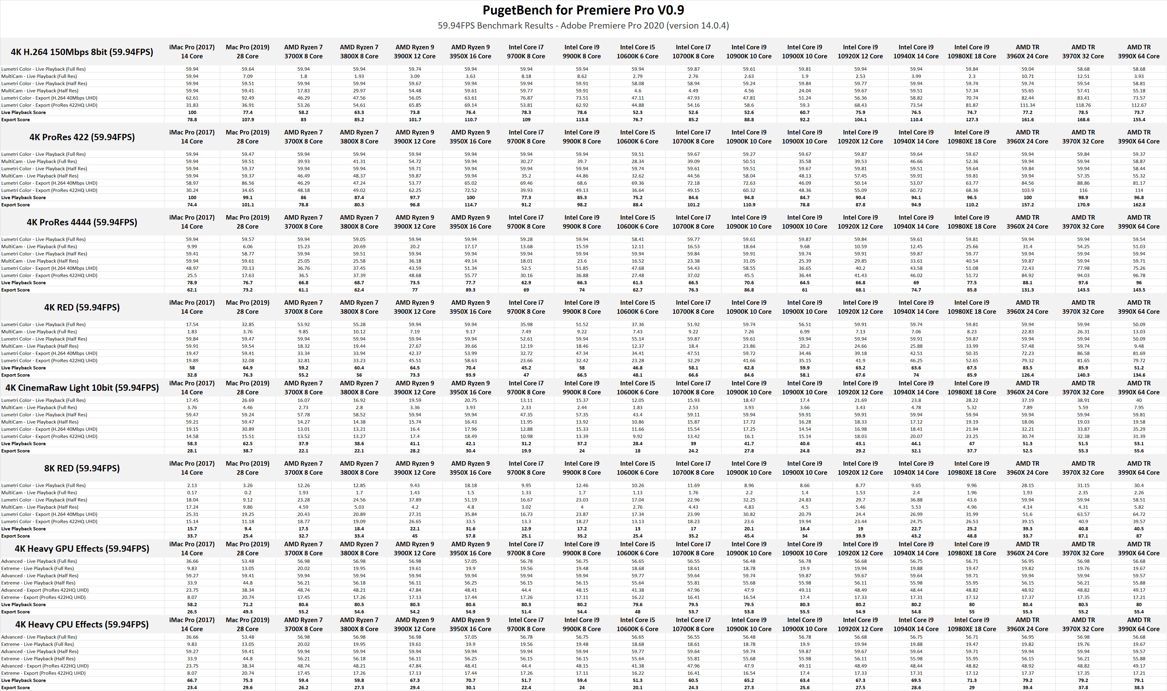

Hello, would appreciate some opinions on the below spec.  I mostly edit 4K video in Premiere as well as a lot of work in Photoshop & After Effects.  I also use ffmpeg and imagemagick a fair bit.
Dell Precision 3640 Tower
MT - Core I9 10900K 3.7 GHz - VPro - 32 GB - SSD 512 GB
Any thoughts or concerns?  The processor seems fairly good looking at benchmarks - https://www.pugetsystems.com/pic_disp.php?id=61386
Would really appreciate knowing if anyone has good / bad experience with this.

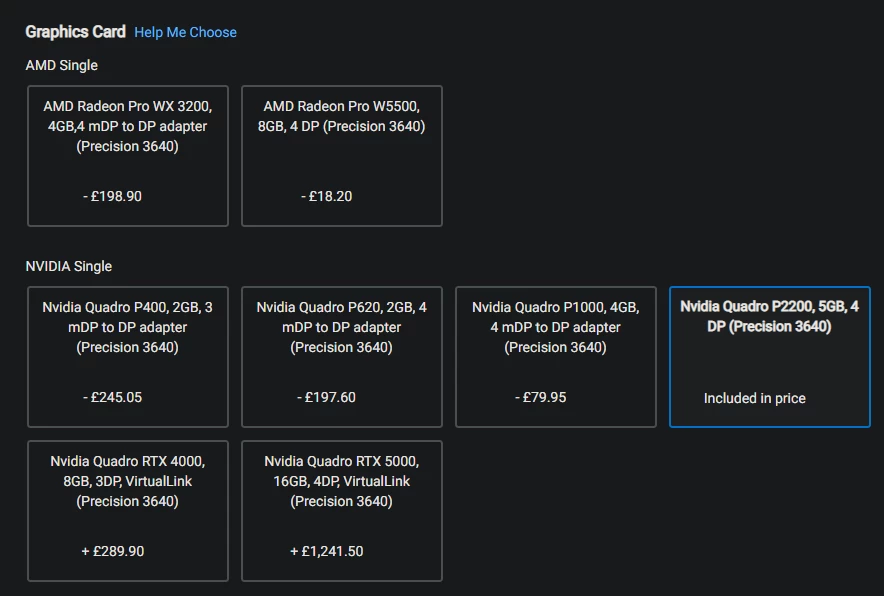

Part of the reason I wanted to get feedback on the spec was to check that it would work long term and make sure there weren't known problems with any of the hardware.  I very much doubt that my company would buy a new GPU in a few months time, so I'd rather ask for a better GPU now - the PC can be customised through Dell, we haven't purchased it yet.
Below are the GPU's available as standard for this machine, would any of these be a good choice or what do you have in mind when you refer to a "GPU that is a better match for the CPU" - should I look for a dedicated GPU separately?  I've gone through so many benchmarking tables and tests that I honestly feel confused about what really is best!!  I don't want to go overboard and overspend but I do want to be able to do my job efficiently.
For that system I would recommend the next GPU choice up from that P2200 (the default selection for your system), the Quadro RTX 4000. The RTX 5000 is even better, but it also costs a lot more money. And this is all because you're purchasing the upgrade from Dell and having them install it for you. Don't go with the P420 or the P620 as they both perform worse than a GeForce GTX 1050 Ti.
The Radeon Pro GPUs in that table are out of consideration at this time as Adobe software still performs relatively poorly with OpenCL (as opposed to CUDA, whose support is restricted to Nvidia GPUs).

EDIT: GPU - NVIDIA Quadro P2200 - 5 GB GDDR5X SDRAM

May 7, 2021 1:45 PM UTC
That GPU is doable, although aging and is a tad slower than a 6 GB GeForce GTX 1060 (the GPU that that Quadro P2200 is based on) due to its narrower memory bandwidth (160 bits instead of the 192 bits of the regular GTX 1060). The release of the Studio Drivers for newer GeForces renders the lower-end discrete desktop Quadros redundant. As a result, except for mobile chips, development has effectively ceased for lower-end discrete Quadro/workstation GPUs. This means that there will be no more new Quadros or workstation GPUs priced under $1000 USD, beginning with the Turing architecture that was introduced in 2018 (where the Quadro RTX 4000 is the bottom of the line for that series), while the new Ampere architecture has ditched the Quadro branding completely and is restricted to the top-end models (such as what is now simply called the RTX A8000). The lower-end Quadros will remain on the same old Pascal architecture until Nvidia announces their EOL and legacy support status at some future date.
May 6, 2021 10:36 PM UTC
You did not specify a GPU. Are you going to get a discrete GPU (graphics card) with that PC? Or are you going to just go with the CPU's integrated Intel UHD Graphics 630?

I also like your pugetsystems chart. It makes me feel good that a i9-10900k, even with 10 cores able to push 5.3ghz, although I am fairly certain that Dell doesnt air cool or for a second, water cool, and my old ryzen 7 3700X holds its own.
