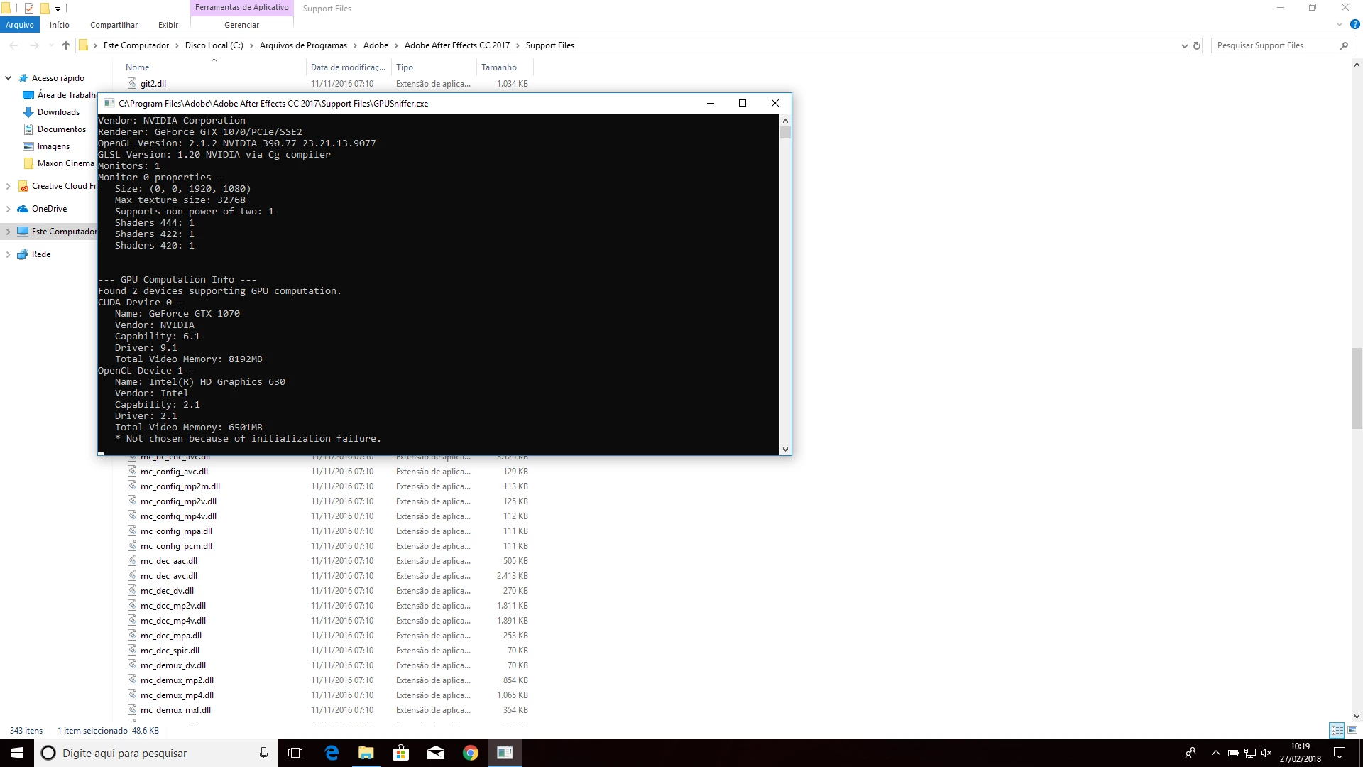

Feb 23, 2018 4:04 PM UTC
Hi.
Ive bought a new notebook - GTX 1070 with core i7 7700.
I have a desktop with the same specs.
I followed this guide, sorta, cuz i guess i cant really disable the onboard gpu on a notebook as it wont work without it as i read on another forum.
I used the sniffer to select the gpu.
But im getting 60h on a video rendering made on after effects, rendering on media encoder.
On the desktop with the same specs i render it in 3h.
As you can see in the pic, its using the correct, gpu but still....
Any hints guys

Feb 27, 2018 1:24 PM UTC
Whoa, didnt know it was giving this error...Anyway to fix? Tks
