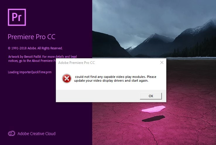

Hello there,
I'm trying the Premiere CC 2019 but at the start shows the issue "Adobe premiere could not find any capable video play modules". I have a Nvidia GTX 1050ti in a desktop pc.
I google it and found that the file GPUSniffer.exe is the one who detects the GPU to adobe programs, in this case, Premiere. But when i started the GPUSniffer showed me this:
GPUSniffer testing 254
Unrecoverable GPU Failure detected
Full Test test failed, trying No Metal
At this moment, I cant open the Premiere App because of the "video play modules".
I aprreciate any help. Thanks.

Same issue here... I have a RTX 2060.. Updated Nvidia drivers 3x over span of 2 months to the latest. Reverting back to 13.0.1 works just fine.
Jan 28, 2019 7:39 PM UTC
Same exact issue, Premiere Pro 18 at least loads but only uses the CPU. Does not detect my graphics card. (RX 580)
Fresh install of display drivers, no luck.

I also have the GTX 1050 Ti  and I also have this problem with ver 3.0.2. Ver 3.0.1 works fine, so I doubt that the given advice will help - I've gone through this with no positive result whatsoever. Neither the current ver 417.71 or previous versions have solved the issue. I can only suggest going back to an earlier version - for me it is 3.0.1 and there are no problems. The programme loads and works as it should.
The GTX 1050 Ti is well within the required specs as it has 4GB Ram.
For some reason this problem affects some and not others.
There are a few threads related to this theme, both in the Hardware section and Premiere Pro section.
You will probably have to wait until Adobe releases a 'fix'.

Try updating or rolling back your graphics driver directly from the video card manufacturer’s site.
