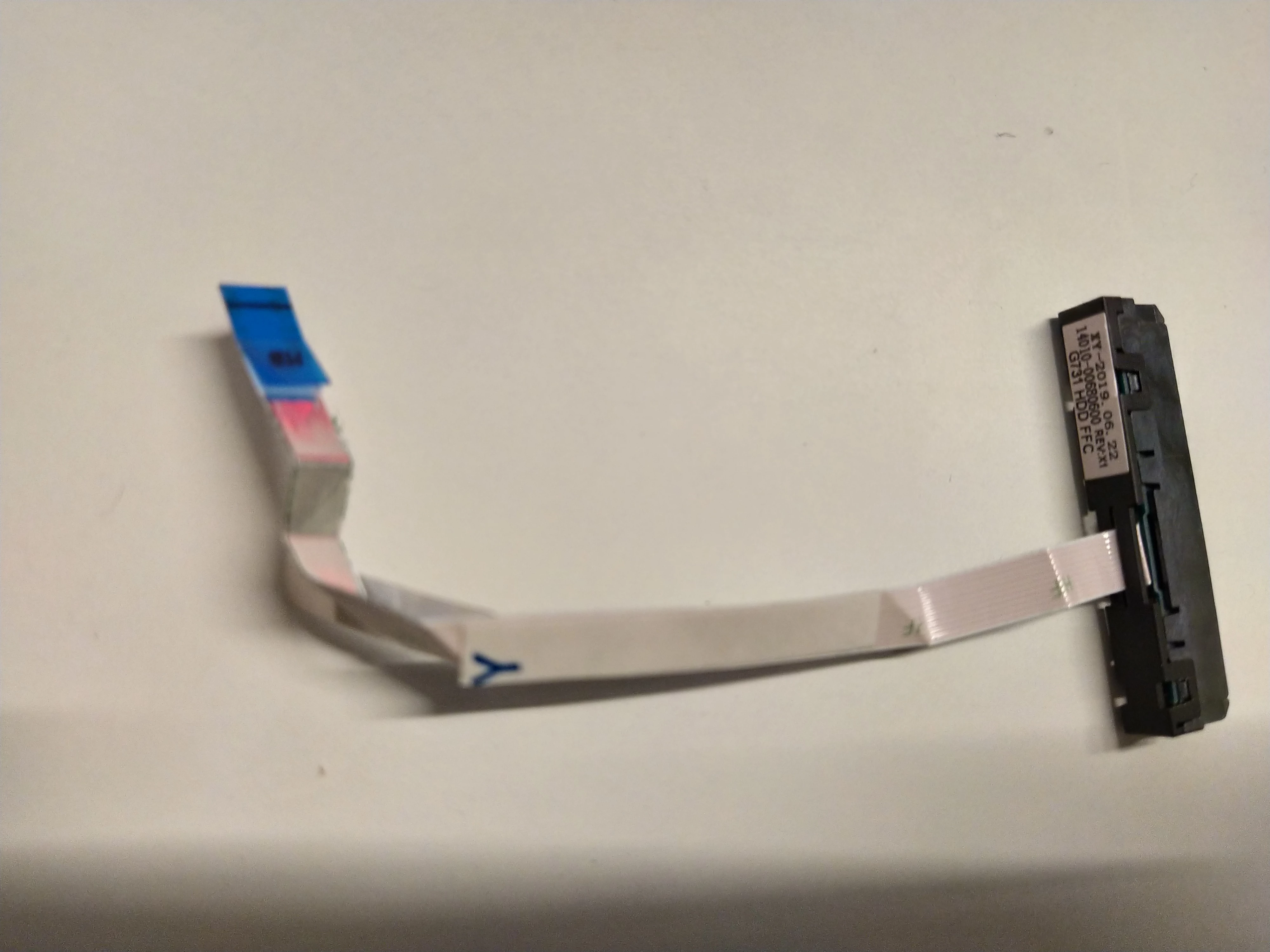

As I couldn't afford a new PC right now, I am planing to upgrade my laptop with the following:
  1. Increase the RAM to 32 GB from 24 GB (There are 2 slots inside, 1 with 8 GB and other with 16 GB). So I am planning to replace 8GB with 16 GB.
  2. Put an extra SATA SSD for Media files and scratch disk alone (There is still a vacant slot for HDD inside the laptop but it can be connected only with SATA).
Will this help me with performance right now? Please suggest anything you could. It would be a great help. Thanks

    See how things go after adding the SSD media drive, as it should have been added from the get go. All editors should have a 2nd SSD for media, minimum, it's standard setup protocol.
    Please also look at your Memory preference. You might try switching rendering optimization from Performance to Memory. That might help too.
    Other than that, working with a more powerful CPU, more RAM (especially for After Effects), and VRAM (for PPro) can all help a graphics heavy workflow.
    Hope we can assist you further.

    You mentioned in the private message that it is better to connect the SSD with USB 3.0.
    Although this is possible, I thought it would be neater for it to sit inside my laptop which can be connected through a SATA cable provided with the laptop.
    Is there a disadvantage using SATA instead of USB 3.0?
