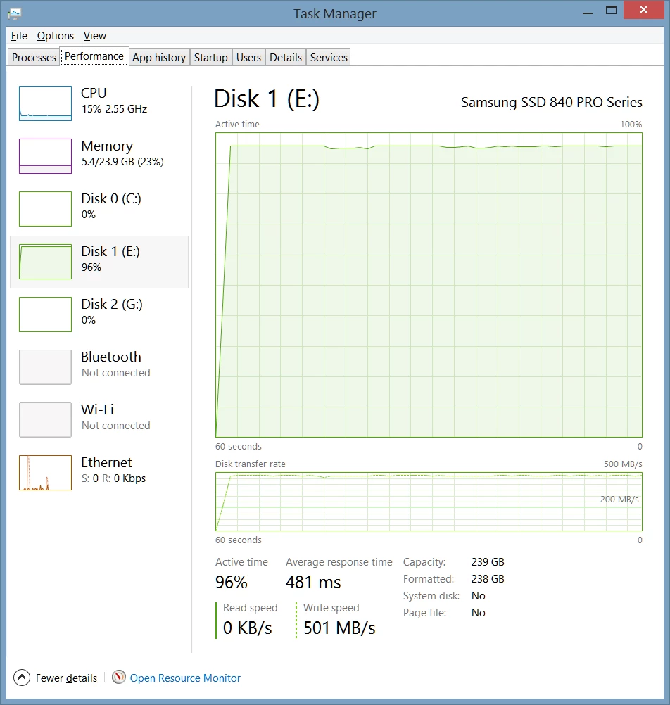

Bill Gehrke
Apr 24, 2016 9:28 PM UTC
CC2015 (Premiere 9.2) can use 100% of CPU and all the speed available on the SSD.  It must just be dependent on the media and the applied effects or some other unusual setup on your system.  Here is my PPBM9 CPU intensive benchmark on my laptop.
As far as the SSD performance goes here is the disk intensive benchmark showing 96% utilization of a Samsung 840 Pro and a SSD write rate of 501 MB/s
Apr 25, 2016 3:25 AM UTC
