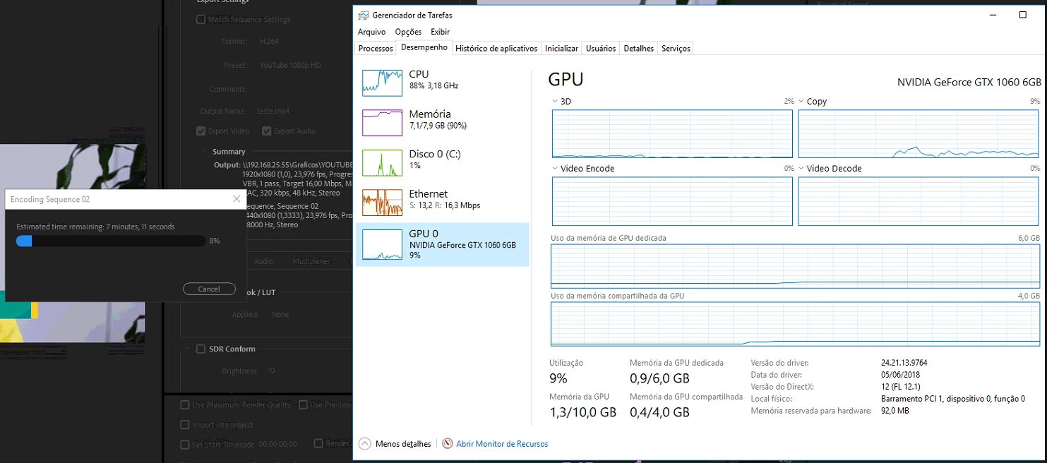

My PC is not using 100% of GPU
Hi guys, I have a PC without GPU and render time was very slow.
So, I got with a friend one Geforce GTX 1060 6Gb and install it today.
The render time reduce a lot, from 15min to 6min for ex.
But the use of GPU is not in 100%, the configuration at General/Preferences is Hardware Aceleration with CUDA.
The memory in GPU was very low to, but my output file was only 650MB.
Now I need to buy a GPU to me, and return this to my friend.
With I´m not using 100%? It´s because my CPU or RAM?
If I buy an GTX 1050ti the perfomance will be the same in my case?
I´m glad with 6min of render, and don´t want to change the PC.
In my home I have anothe PC, with a core i5 8400, maybe with this CPU should be faster?
The files are in my server, and I acess them directly to work by the network.
But I noted that Premier do a buffer in my PC, and only export the final file by the LAN at the end, so, my 100Mb LAN should not be a problem.
My PC:
Intel Core i5 4460
Asus H81M-A/BR
8Gb DDR3 1666Mhz
SSD Kingston 120Gb SV300S37A120G
100Mb LAN
Thanks!

    Thank you, probably my video is not using all effects that need CUDA, and it´s using more CPU instead.
    I will try the same GPU at i5 8400, and check if the results are better.
    Maybe I can change the CPU´s, and increase the RAM do 16Gb.
