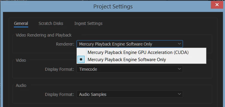

Preview I was using Adobe Premier CC 5.5 and CUDA support working excellent. Now, I'm on Premiere 2017 Pro, payment license 1 year.
My symptoms are to not obtain a yellow process line in my timeline edit area. When not obtain this color in process line over recording clips, it means my hardware system are not using my CUDA option, and rendering are slow motion i work issue. My GPU card Nvidia GeForce GTX 970 have this CUDA SUPPORT and function.
Also, my working edit are not smoothly in process.
During editing of video clips, chopped changes are encountered during playback, all the reasons that my GPU card is not set up correctly for CUDA support.

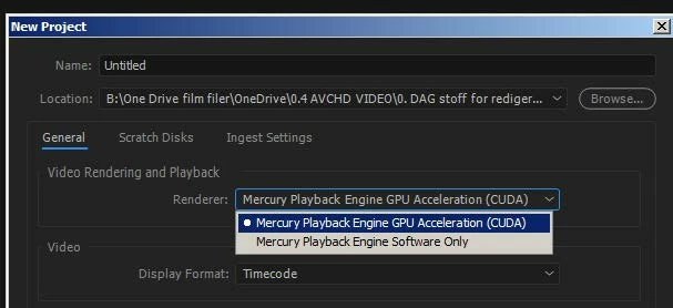

    After you bring up Premiere have you tried to turn it on after Premiere comes up?
    Some times the first time Premiere comes up it does not find the card.

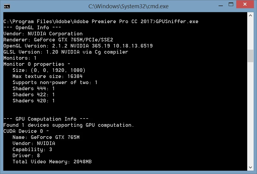

    Open a CMD window and run GPUSniffer.exe and show us what you get like this.
