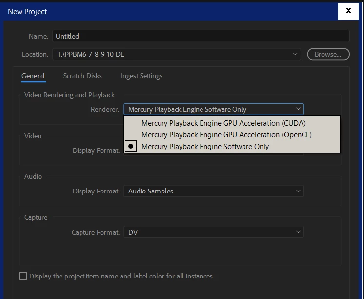

    Just for you I ran an experiment.  In my experimental computer I have normally an nVidia GTX 1060 .  I decided to also install an AMD R9-280X next to it to see how these two would get along and if they could coexist.  Amazingly they coexist well.  I started a new project and in the startup screen I was offered all 3 options (CUDA, OpenCL and software) for the Renderer as you can see

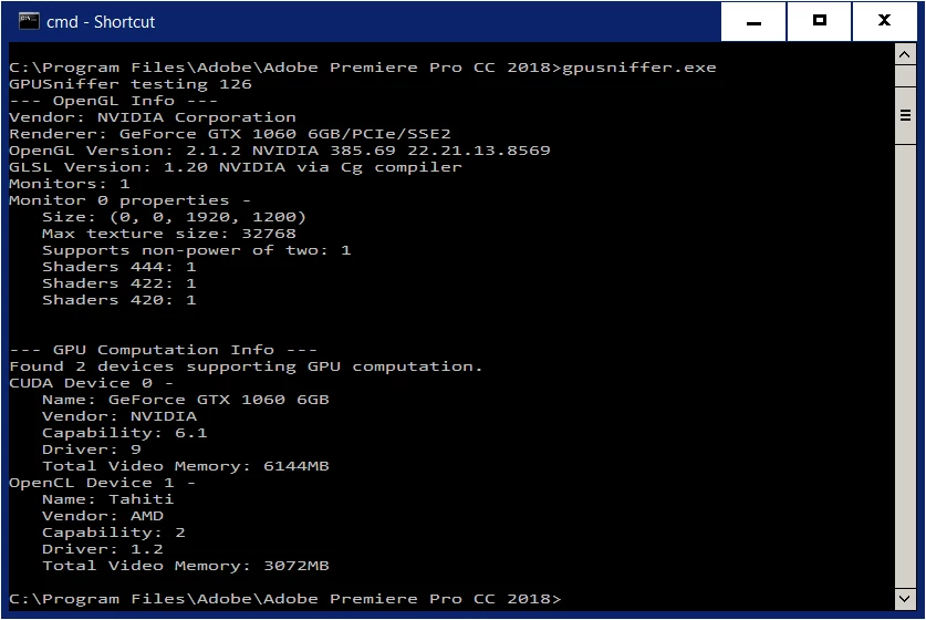

    I also ran GPUSniffer with this setup:
    To further test this strange pair of GPU's I ran my Premiere Pro BenchMark and the GPU intensive test I got 44 seconds for the R9-280X and as usual the CUDA card outperformed it by scoring the same test in 32 seconds.
    Your pair of AMD cards you indicate SLI, that term is only nVidia for AMD they use the term Crossfire.  I would strongly suggest you unlink those cards and make sure you have current drivers and in my opinion they should coexist although I cannot imagine any editing purpose for the combination.  You cannot see activity of GPU acceleration on both cards at the same time, it is either one or the other.
