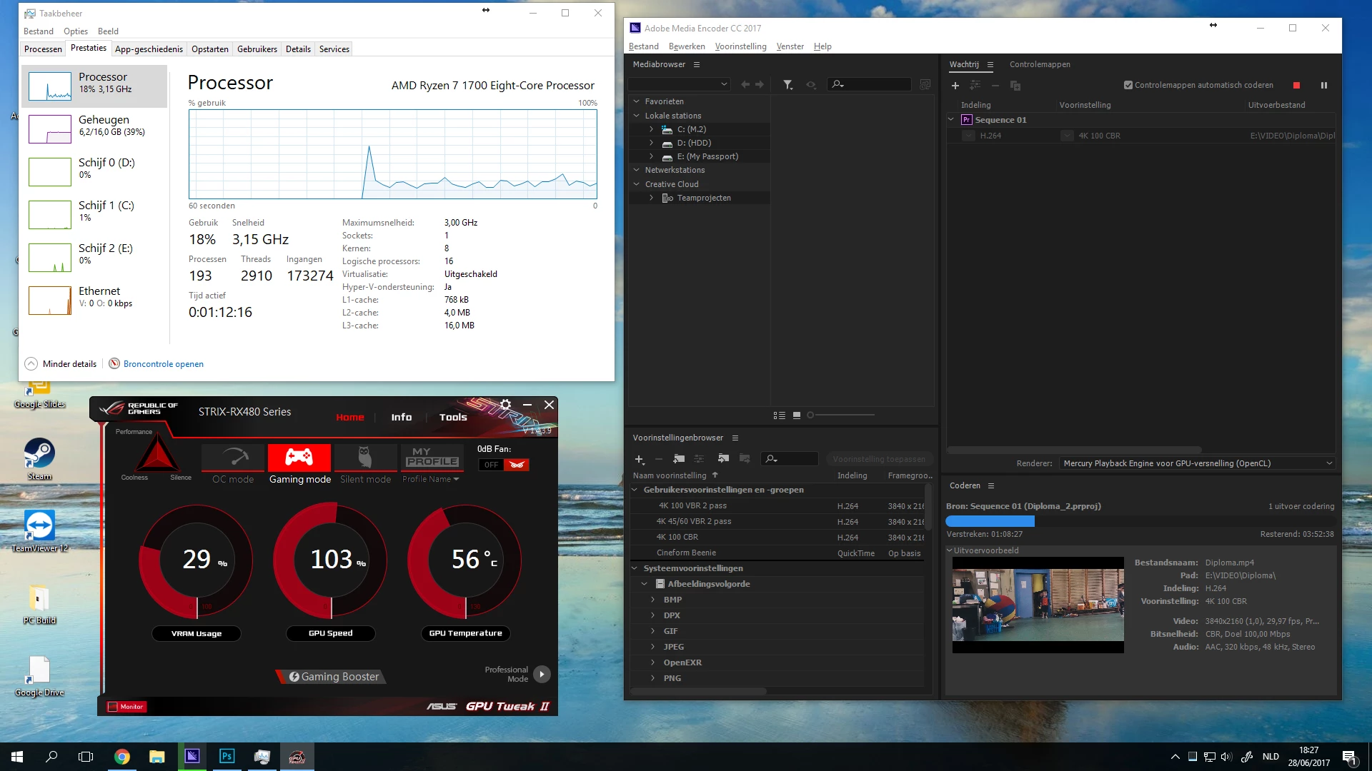

Nothing maxes out (cpu/gpu/memory) when rendering
I'm rendering 4k footage, with multiple effects (After effects transitions, Magic Bullet effects (denoiser), sharpening, grades, correcting gopro distortions, etc... out with Media Encoder, set to high quality, h.264 100Mbit CBR. Original footage is h.264 4k, vbr.
Is it 'normal' that nothing is maxing out in terms of GPU, CPU and memory?
Everything is at 20% and I can't really find the bottleneck?
Here's my setup:
Ryzen 1700 (15-20% usage), spread over all cores
16gb of ram (20-40% usage)
GPU: RX480 16gb (29% vram usage)
All temps are within range as far as I can see.
Disks are barely being used from what I can see.
Memory usage is set to 13gb, 3gb for other applications, and the render engine is GPU accelerated.
Shouldn't at least one thing be maxing out and be the bottleneck?
I basically have 75% of my system doing nothing when exporting? Kind of a bummer, or to be expected?
I am reading about that AE doesn't use the cpu's that well, so that might be it?
I am aware that stacking up effects, AE elements etc isn't ideal, and I would be fine with long render times is it was actually maxing out something, but this is just bizare to me...
Any ideas?
Also: would transcoding to an intermediate codec like cineform speed up rendering? (I know it'll scrub faster, etc... but I'm talking about outputting to h.264 specificaly)

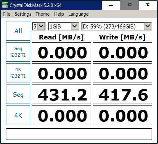

"Media is stored on a 3th WD MY Pasport Pro, with 2tb free, plugged into USB 3.1 port."
Check the speed of this device with something like HDTune.  It could be that it might even be a 5400 rpm drive but in any case it is just a single hard disk drive.  If you really want to use that USB3.1 port on your computer my suggestion is get yourself a Samsung T3 USB 3.1 portable SSD which will give you speeds like this.
For video editing your media files are sequential read operations.  I use these devices daily on my laptop.  I have all the project files on it.

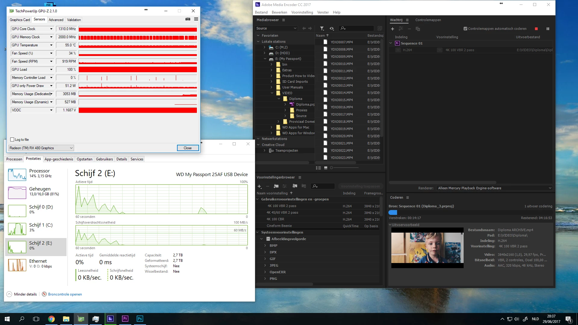

amkrisisAuthor
Jun 29, 2017 6:47 PM UTC
You're right!
It's maxing out at 100% as soon as my intro (which is a cineform output) hits the encoding.
I believe most MB effects are GPU assisted as well, so you're probably bang on.
I am however seeing quick drops of the gpu memory clock, it's running at 2000MHz, and drops to 300MHz very quickly and then shoots back up again (see screenshot). It's
Impulsive as I am I allready ordered a 2tb hdd (7200rpm) and a 250gb Samsung EVO 850 which I'll set up as a scratch and cache drive. But I guess I won't see any drastic improvements unless I avoid using GPU heavy effects like the denoiser.
Not sure if I even need it, I just wack it on there when the ISO was high for good measure so...
So, the cpu doesn't pick up where the gpu left if it's maxed out? So they aren't balancing the load I guess?
Anyway, since the drives are on their way I'll use them.
One extra question though: if I use the ssd as a scratch and cache drive and I'm encodingor editing, will it run into issues when it's full, or does the software manages it automatically and clears it when needed?
I quickly changed the cache and scratch settings to the slower drive (away from the OS SSD) and noticed that the folders are only a few mb big each? I thought these would fill up rather quickly?
