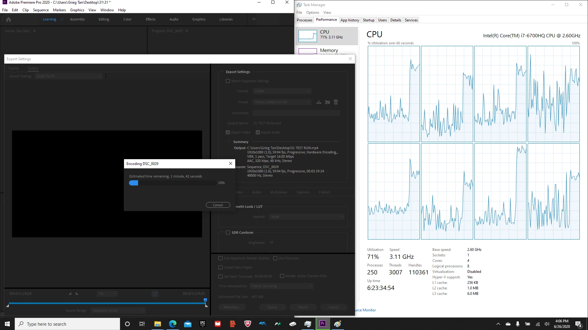

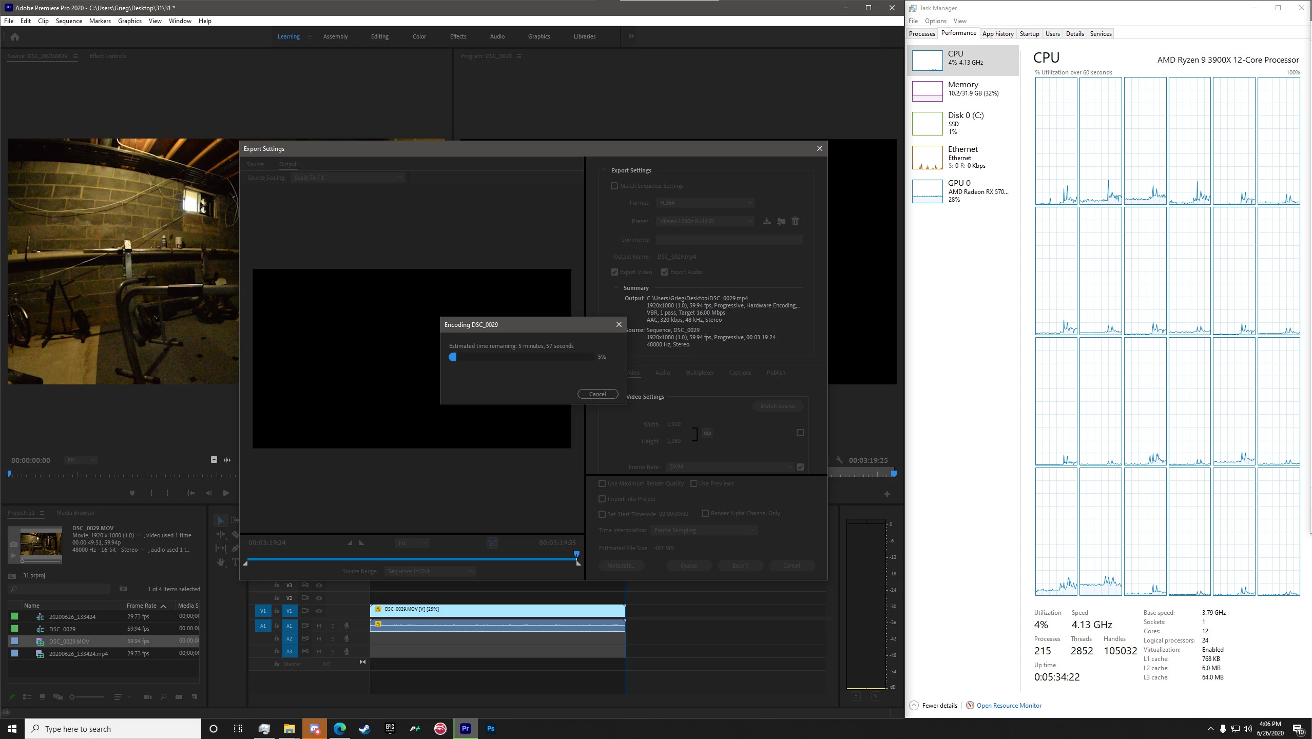

Create a project on the desktop and place all media and the project file in one folder. Make the video longer, maybe 5 minutes and then export. Before exporting, press Ctrl+Shift+ESC to start the Task Manager and click on the Performance tab so you can see how the hardware performs.
When done, copy the folder to your laptop and open the project and export. Use the Task Manager this time as well. By doing this you make sure that you use the exact same project since it is easy to miss to add, or not add, an effect if you create two different projects.
Any difference?
In the Task Manager, right on the CPU graph to the right and choose Change graph to > Logical Processors so you see each individual core.

I made IDENTICAL folders on each machine's desktop and also exported to the desktop. Used the same raw video file and the only effect I applied was changing the speed to 25%. Both video lengths are 3:19 and both file exports are 407mbs. The laptop took under 2 minutes while the PC was just shy of 6 minutes. I took screenshots shortly after hitting export on both machines so you can see what the cores are doing.

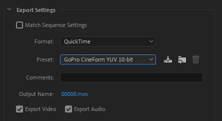

I have only used Intel processors and have none experience of the Ryzen processors. Did you build the computer yourself? No matter what, make sure that the latest chipset drivers, etc are installed. Maybe try to export without any speed changes, just the clip and the Lumetri filter on.
Try this as well, to rule out any hardware accelerated issues when it comes to H.264 encoding. Export on both computers to CineForm and see how that performs. See the settings below.
