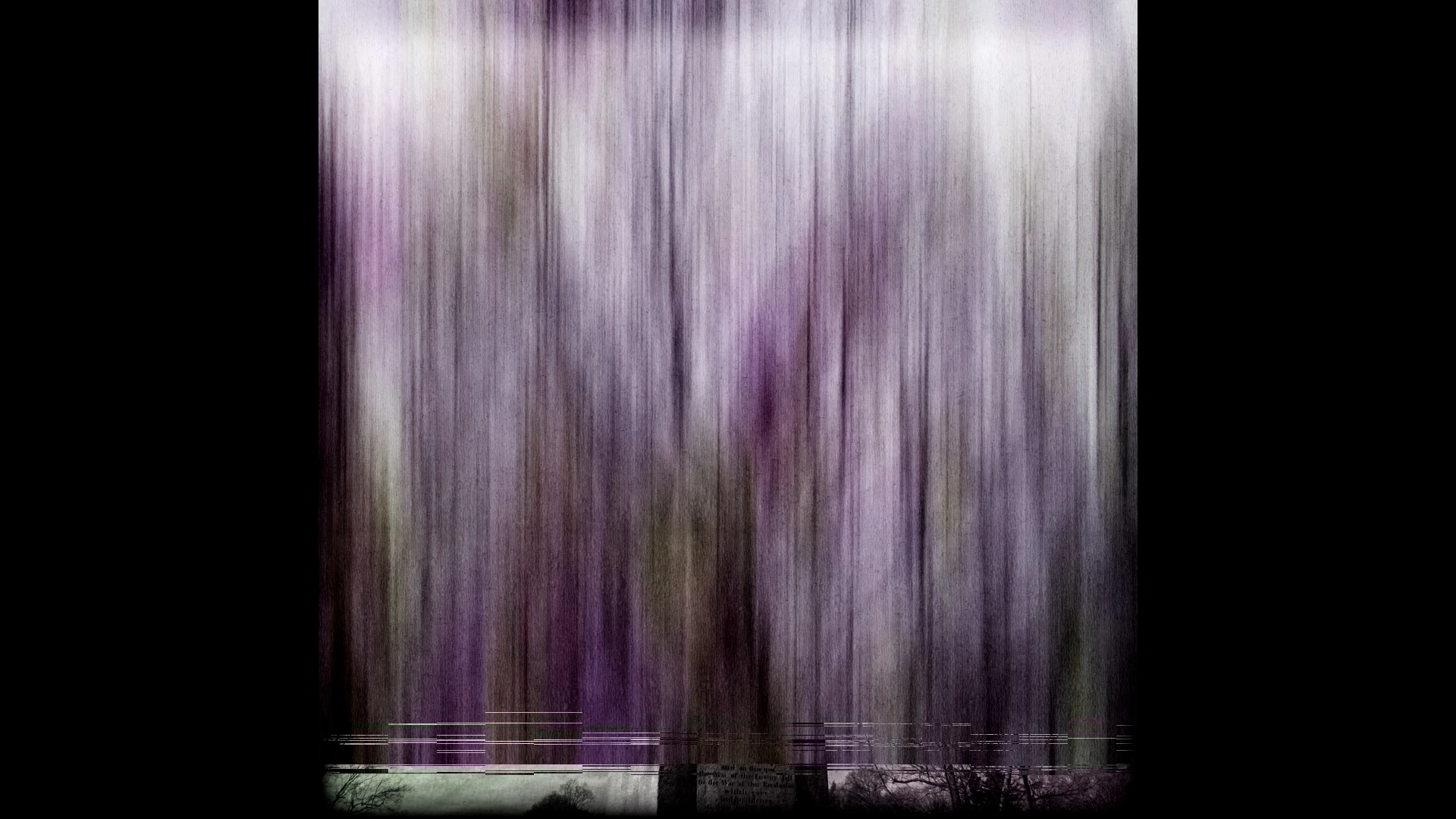

Hi, all,
So I was happily chugging along in Premiere Pro dynamically linked to After Effects for a demo reel I was working on. Everything is fine and it successfully renders the video as an MP4.
But I go to do a final check on the render and I get these strange glitches that happen every now and then. I've tried several ways of exporting (both alone via the Export command, and via Media Encoder). All give the same result. The only way I can get around it is if I use software rendering. Not a bad solution, but not ideal, either. This obviously wittles it down to the GPU, but why?
Example of a glitch:
Example of the glitch in motion (watch between 18 and 19 seconds; it's very quick):
As I mentioned, everything is absolutely fine (playback, effects, performance, etc.) up until checking out the final render. It's...weird. The only thing I can figure out is that during these "glitches," they seem to happen between clips on the Premiere Pro timeline that are up against each other, end-to-end. Again, they do not show up until viewing the actual export. Playback is not affected.

Using an Intel Arc A380 (yes, I know it's not that big a powerhouse of a GPU, but it should handle things like this with aplomb; I am also aware that the CPU does not have an iGPU). I have tried the latest driver (101.4972), as well as the previous version. Both give the same result. Also using the latest versions of Premiere Pro, After Effects and Media Encoder. (All version 24.0.3.)
If anyone has any insight, I'm all ears. (Eyes?)  😄

War Unicorn
Jun 28, 2024 11:46 AM UTC
Unfortunately, I did not. I upgraded to an NVIDIA GeForce RTX 4060 Ti and, as expected, the problem went away.
It's unfortunate that the Arc series doesn't have the support that the NVIDIA (and maybe the Radeon series) does, but it is what it is.

Dec 6, 2023 12:36 AM UTC
I was able to render without problems, but it also happened to me that I couldn't render with hardware. Even removing 23h2 from Windows, the problem continued. (it froze when rendering)
I went back to the latest version v23 and now I can render with hardware.
I reinstalled the 23h2 update, because apparently this was not the problem.
The problem is in Premiere V24 onwards.
I am writing to update my first comment, I hope you were able to resolve your problem. Blessings

Dec 5, 2023 5:37 AM UTC
Hello friend, I had a similar problem, and I discovered that it is version 23h2 of Windows 11.
Go to Update, then "Update History" and delete build 23h2 and reboot and try to test.
It worked for me, Premiere froze a lot and when closing it also did a lot. Try deleting the update and voila.
