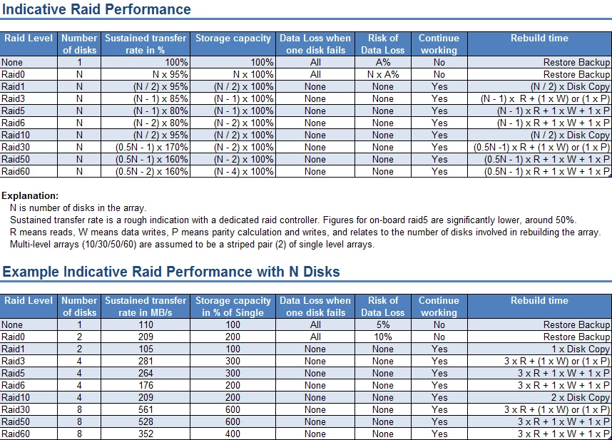

What are the performance gains to be expected from a raid and how long will a rebuild take?
The  most important column in the table below is the sustained transfer  rate. It is indicative and no guarantee that your raid will achieve  exactly the same results. That depends on the controller, the on-board  cache and the disks in use. The more tracks you use in your editing, the higher the resolution you use, the more complex your codec, the more  you will need a high sustained transfer rate and that means more disks in the array.

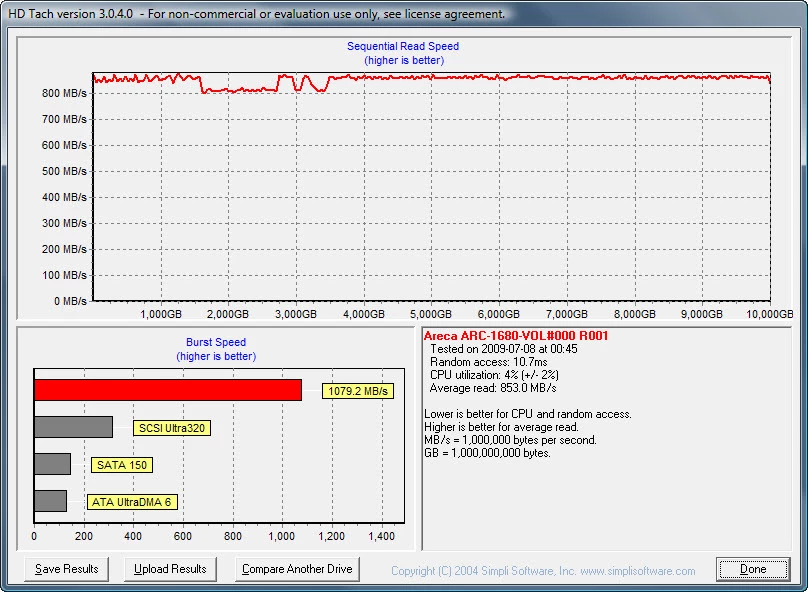

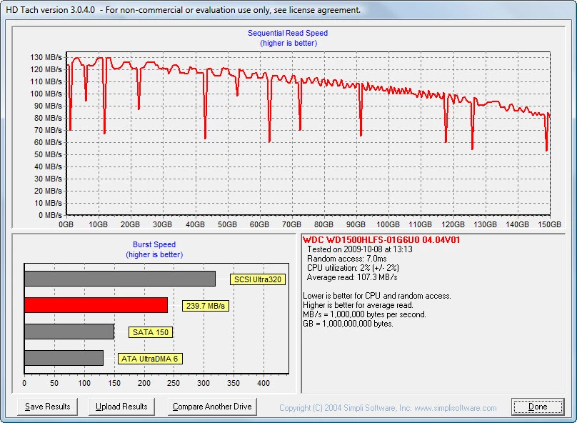

    Keep in mind that a single disk shows declining performance when the fill rate increases. See the example below:
    A Raid3 or Raid30 will not show that behavior. The performance remains nearly constant even if fill rates go up:
    Note that both charts were created with Samsung Spinpoint F1 disks, an older and slower generation of disks and with an older generation Areca ARC-1680iX-12.
