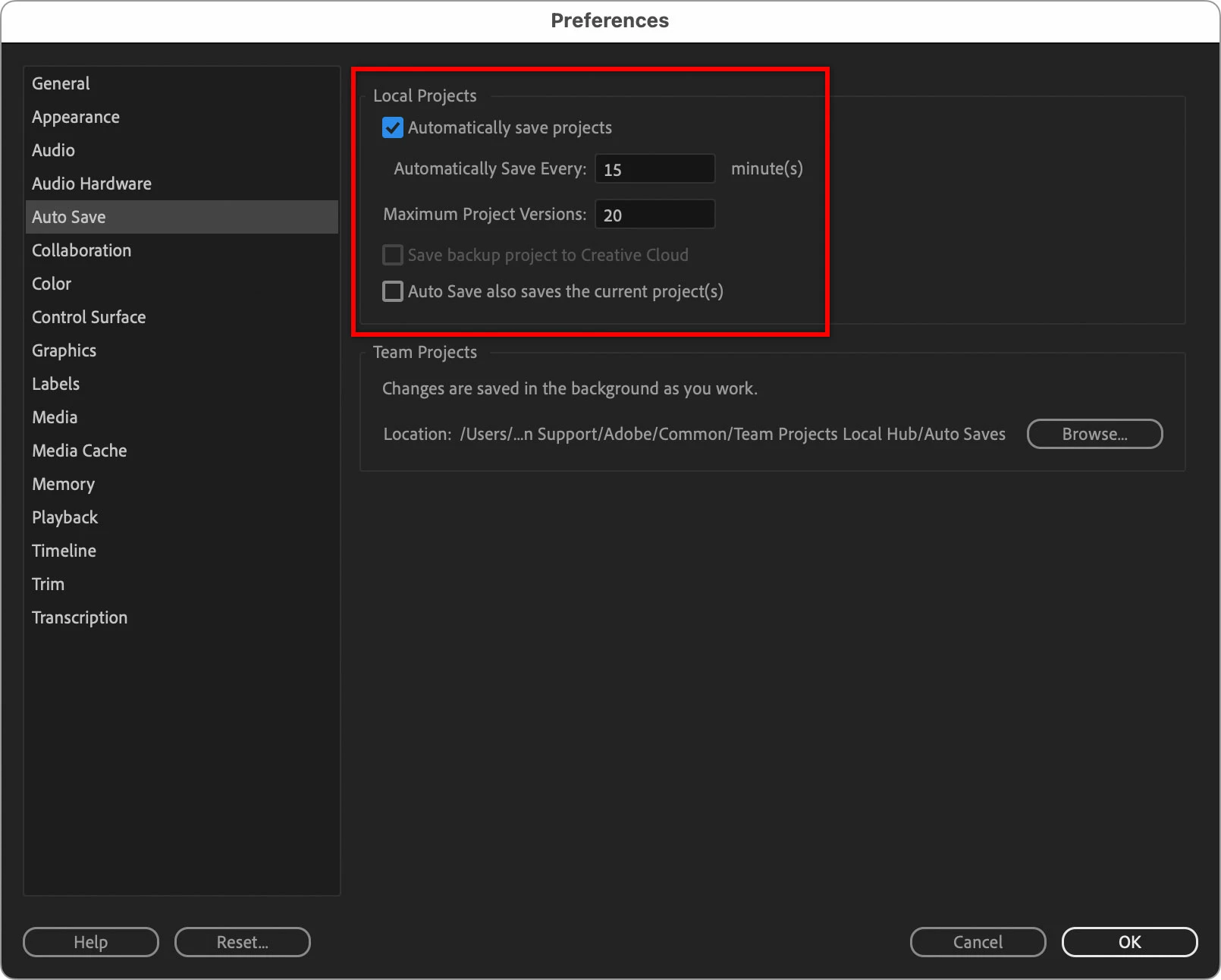

There are a couple of Premiere Pro settings you might want to try.
The first one is Auto Save, in Preferences (see picture below). If you set it up an enable it, Premiere Pro will save Project Versions to an Auto Save folder inside the project folder so that you can roll back to an earlier version. However, that location is where the project is, so to change that to a place on the Mac, also set the option in the next picture…
In File > Project Settings > Scratch Disks, set Auto Save to a specific location, like on your Mac. The problem with this is that it’s not at the application level, it’s at the project level, so you have to remember to set it for every project.
