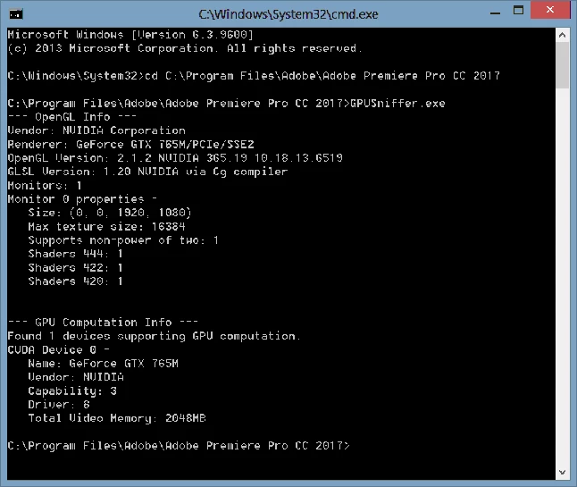

Have you run GPUSniffer,.exe in a command window?  Here is my laptop.
Another way to try is to download GPU-Z and set it to start when you bootup.  I believe that with the new high speed SSD's that Premiere does not have time to initiate GPU acceleration in some systems.

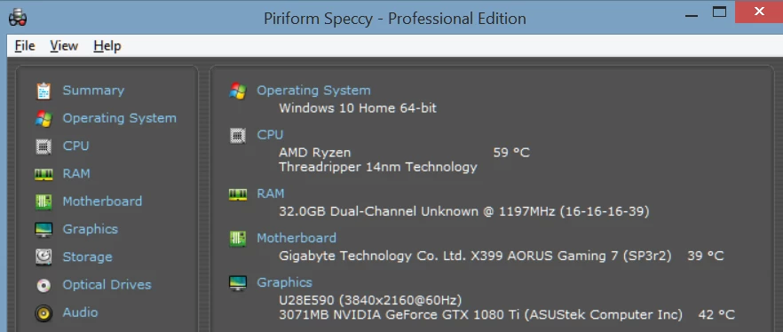

Here is Max's PPBM scoring and basic configuration info:
"34","52","13","156", Premiere Version:, 11.1.2.22
I did not include the storage configuration as Speccy is not specific about what is being  used for what purposes so disregard the 34 second disk intensive score.  Also note that this was not the greatest speed memory.
