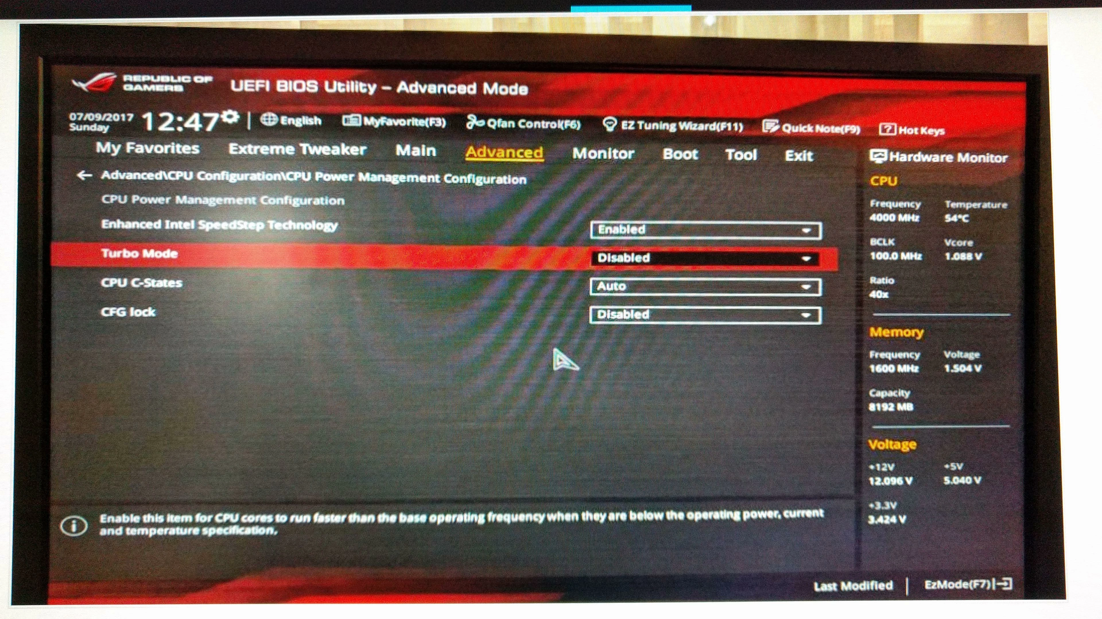

i have premiere 2017 pro , and i try to render movie and i get BSOD screen, i managed to understnad that only when my CPU works on turbo mode i get these screen and only in render in 720P and up, so i disable these turbo mode and everything is works correct (except two times i got the BSOD)

    Does Turbo mode change the v-core voltage?  Do you have that option in the Advanced config window?
    Does the BSD occur straight away?  If not, how high does the CPU temperature get before the crash?
    Is this a laptop?  If not, what CPU cooler do you use?

    it's desktop and the cooler is the one that come OWM that didn't do any problems till now
    the BSOD is looks like these: WHEA_UNCORRECTABLE_ERROR
    i don't know how to see it, will glad if you tell me how and what to look for
    Do you have that option in the Advanced config window? where please?
    Does the BSD occur straight away?can be straight and can be not (one's it was after 50% of rendering)
    how high does the CPU temperature get before the crash? where can i see these too?
