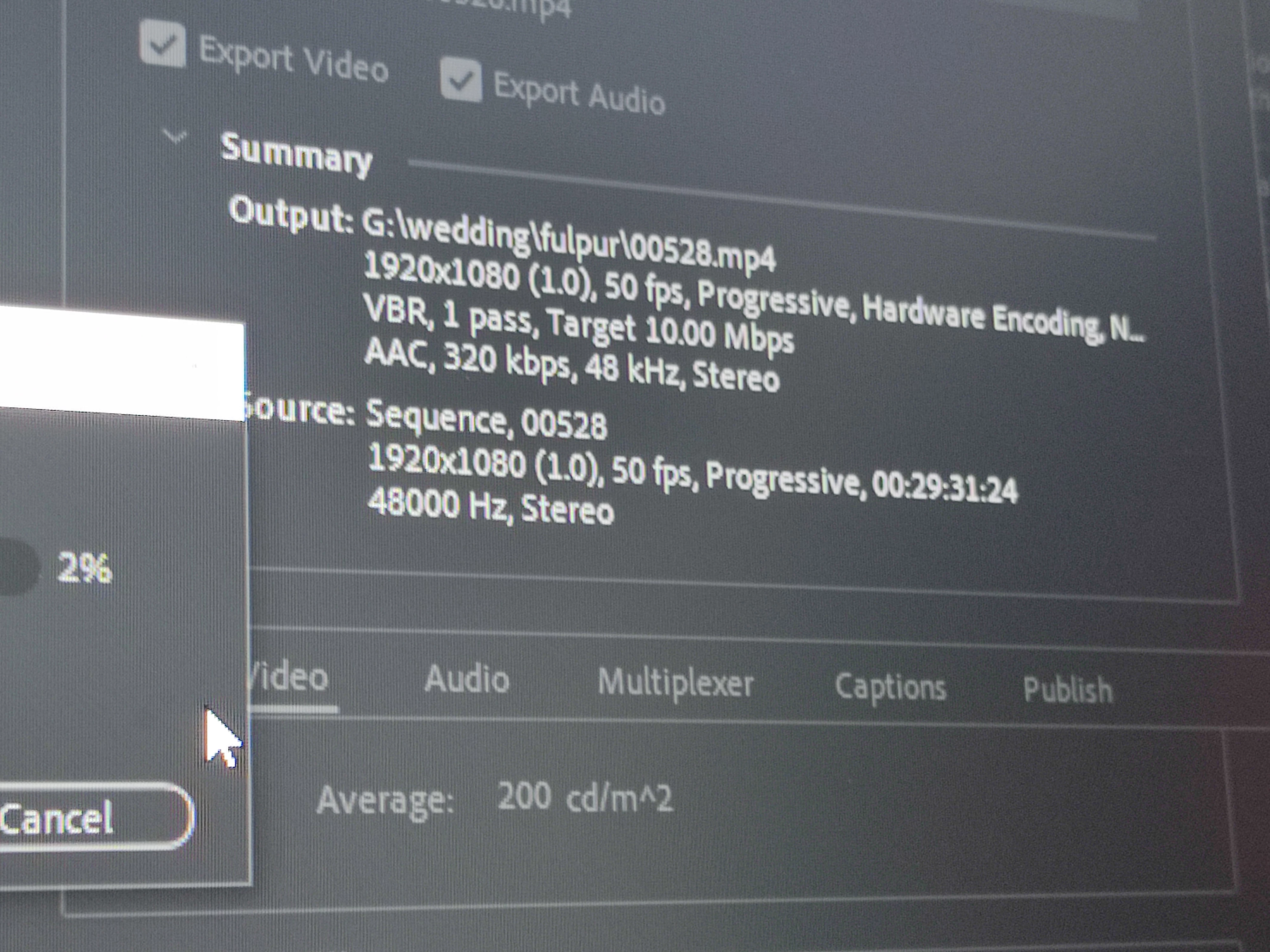

Oct 24, 2021 8:55 AM UTC
hey could you help me find the setting for this
i am also having similar issue where hardware encoding option is showing but on clicking it gives error message your pc doesnt meet requirements
on seeing your post i saw my export setting was set to upper
but i cant seem to find the option to set to progressive

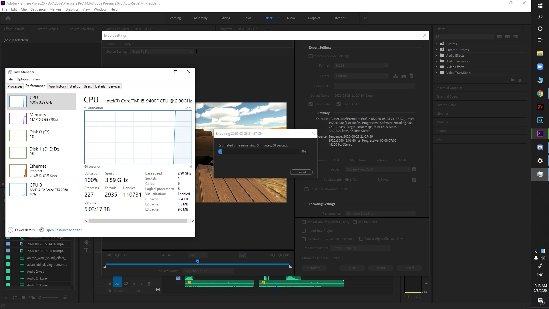

Bi5ED5Author
Sep 2, 2020 5:14 PM UTC
Thanks but why when im rendering my cpu keeps runs at 100% and my gpu only stay ~ 10% here's a screen capture of it
