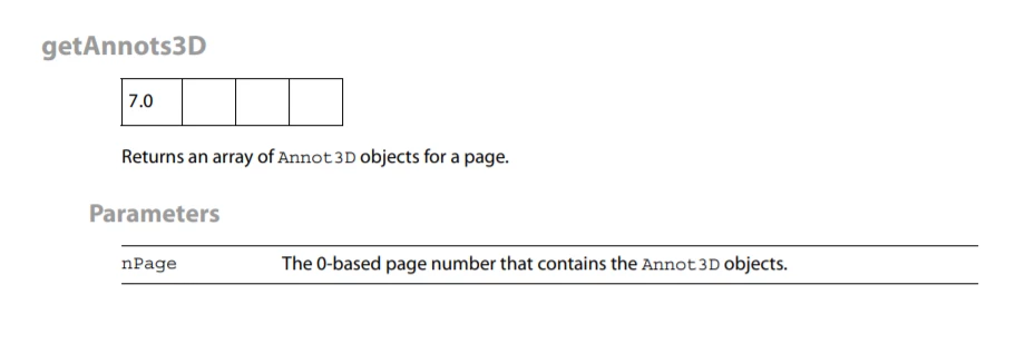

Thanks for reaching out to us. As far as we understand the concern, you could use the api getAnnots3D documented here to detect the 3D canvas https://www.adobe.com/content/dam/acom/en/devnet/acrobat/pdfs/js_api_reference.pdf.
Please let us know if this helps.

I tried placing this IF stament in my script that is looping through the pages applying the stamps, but I am still getting the stamp. My thought was if Annots3D has been activated on the sheet it will skip to the next sheet. ("i" is used to specify page number.)
if (this.getAnnots3D.activated = true) {
(i = i++);
