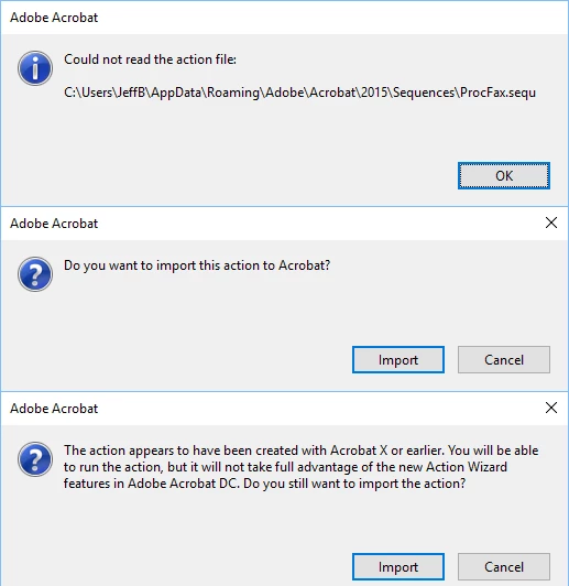

Action item does not work
I have an academic Acrobat Pro DC... My action Item works the first time I set it up but the second time I go to run it, it gives and error stating that has been built by an old version... I tried to even import it but does not work... I am attaching all the screen shot I have obtained bellow... What could be wrong?

I don't have the EverMap plug-in, so I cannot run through the whole action, but because a 3rd party plug-in is involved, I would first talk to EverMaps's support and see if they are aware of any potential problems.

Off course no problem... I will also attach the Action if I can... Here is the sequence of events.2.
1. Select a Folder "all the files in that folder".
2. Do OCR on each file.
3. Optimize the file.
4. Save the file in the same Folder that it came from / Replacing the Original file.
5. Run a Plug-in called Search and Save developed by EverMap.
Does not matter even though if I do not run the last step only the first 4 steps it happens with the same error dialog so it can not be blamed at Plug-in written by EverMap.
Jeff P.
Seems like it only accepts image not any other file type...  Not sure if the text in the file would worth any for you... any how I include it.

Karl Heinz  Kremer
Karl Heinz KremerCommunity ExpertCorrect answer
January 9, 2017
December 30, 2016
Off course in DC.... each time I want to run this Action I have to remove it first then rebuild it all over again...
Jeff P.
December 30, 2016
I am under impression this is a bug in DC... I have even removed it and reboot the system and rebuild it under the DC... After saving it, and I run it for the first time, no problem... but second time or next day... I get the attached dialogue error.
Jeff P.
Karl Heinz  Kremer
December 30, 2016
This may well be a bug. Would you be able to share your
Action, or at least describe what it does?
December 30, 2016
It's not clear to me from your description whether you created the action with Acrobat DC or an earlier version. Can you clarify?
February 13, 2017
I have created action under Acrobat DC and X and XI all are acting the same... No difference.
Jeff Paarsa
February 13, 2017
What did EverMap support say?
