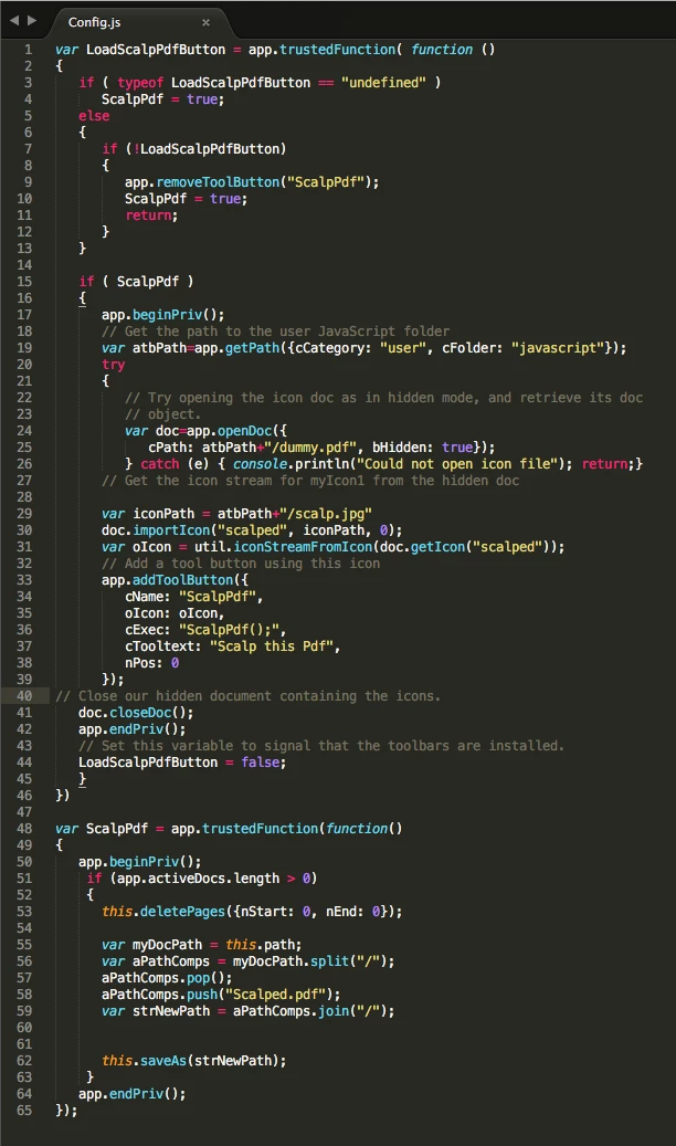

Greetings,
I created a working menu item that removes, or scalps (as my user calls it), the first page of a pdf.
I am attempting to add this as a toolbar button.
Following the documentation, I wrote the following code, which I added in the Javascript folder of Acrobat DC Pro (15.02020039).
I ensured that my jpg used for the icon is 20x20. The dummy pdf is just my business card.
I placed both the jpg for the icon and the dummy pdf in the Javascript folder.
I added all this here for your convenience: AddButton - Google Drive
When I start Acrobat, nothing happens, in terms of having my button anywhere under 'Tools'.
Being this is my first button... I beg for some guidance
Here's the code I have:
var LoadScalpPdfButton = app.trustedFunction( function ()
   if ( typeof LoadScalpPdfButton == "undefined" )
      ScalpPdf = true;
   else
      if (!LoadScalpPdfButton)
         app.removeToolButton("ScalpPdf");
         ScalpPdf = true;
         return;
   if ( ScalpPdf )
      app.beginPriv();
      // Get the path to the user JavaScript folder
      var atbPath=app.getPath({cCategory: "user", cFolder: "javascript"});
      try
         // Try opening the icon doc as in hidden mode, and retrieve its doc
         // object.
         var doc=app.openDoc({
            cPath: atbPath+"/dummy.pdf", bHidden: true});
         } catch (e) { console.println("Could not open icon file"); return;}
      // Get the icon stream for myIcon1 from the hidden doc
      var iconPath = atbPath+"/scalp.jpg"
      doc.importIcon("scalped", iconPath, 0);
      var oIcon = util.iconStreamFromIcon(doc.getIcon("scalped"));
      // Add a tool button using this icon
      app.addToolButton({
         cName: "ScalpPdf",
         oIcon: oIcon,
         cExec: "ScalpPdf();",
         cTooltext: "Scalp this Pdf",
         nPos: 0
// Close our hidden document containing the icons.
   doc.closeDoc();
   app.endPriv();
   // Set this variable to signal that the toolbars are installed.
   LoadScalpPdfButton = false;
var ScalpPdf = app.trustedFunction(function()
   app.beginPriv();
    if (app.activeDocs.length > 0)
      this.deletePages({nStart: 0, nEnd: 0});
      var myDocPath = this.path;
      var aPathComps = myDocPath.split("/");
      aPathComps.pop();
      aPathComps.push("Scalped.pdf");
      var strNewPath = aPathComps.join("/");
      this.saveAs(strNewPath);
   app.endPriv();
Thank you for your advice.

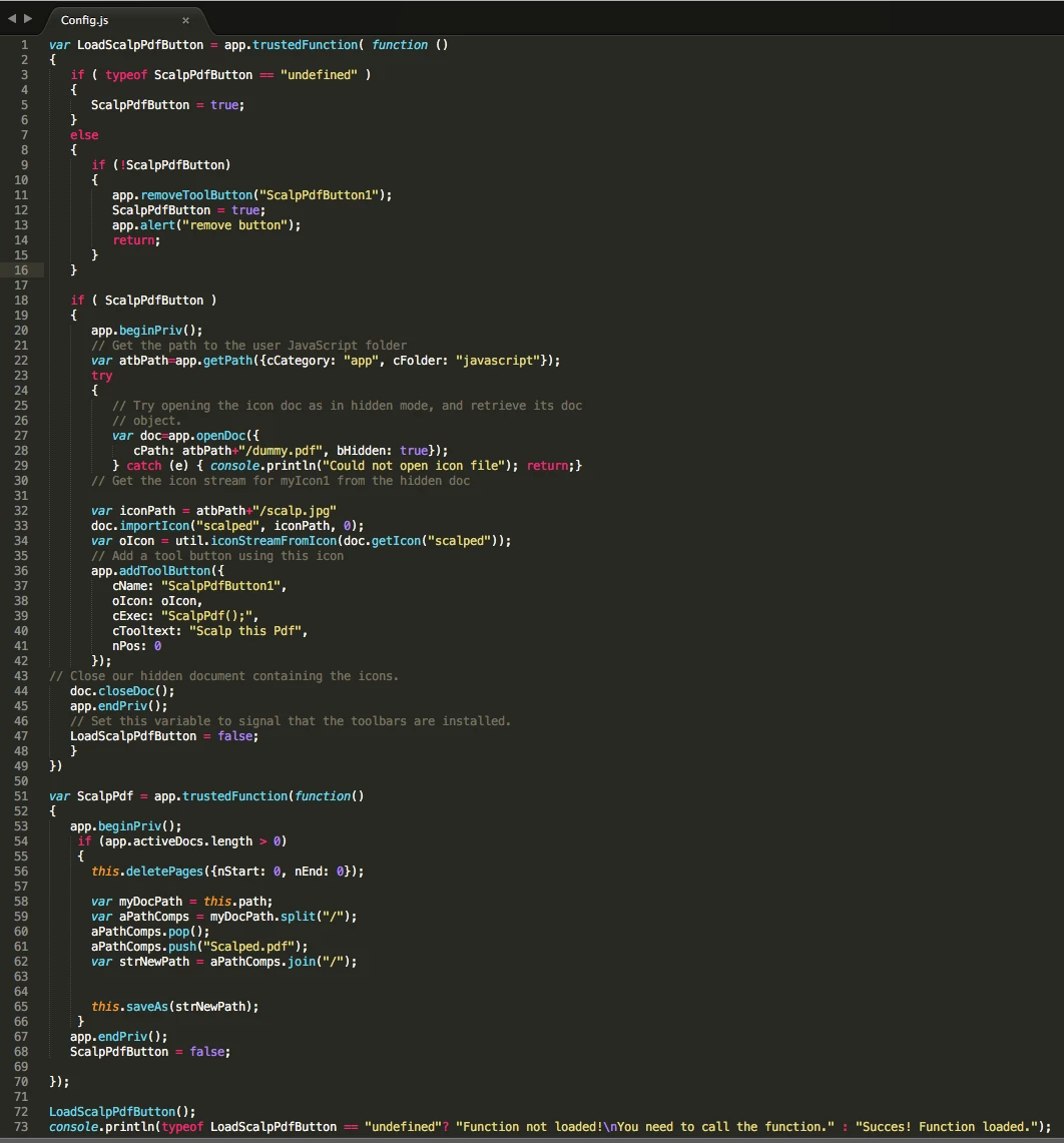

Das Boomer
October 17, 2016
I followed your good advice and added the console.println at the end of the script and it appears it loaded fine.
So now, rather befuddled, I have to figure out where it, since I cannot see it in the ui.
I have added the current script in the google drive for your convenience.
Thank for your time.
Antoine
Bernd Alheit
October 17, 2016
Where did you call the function?
Das Boomer
October 17, 2016
Greetings,
Indeed. Embarrassingly enough, I had not called the function in my code.
Coding after a long day is maybe too much for me without caffeine.

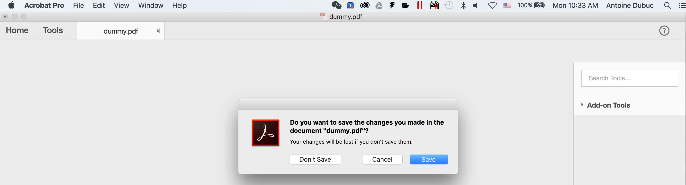

I now have Acrobat opening up and showing me on my left screen the 'dummy' pdf used in the code asking to save or not. Interesting is that in that window I at least see the section 'Add-on tools' that, whether or not I save, never actually shows my tool in the list on my right hand side screen where the pdf I opened to start acrobat is displayed.
Here's what I'm seeing:
And on the other monitor (whether or not I save this dummy pdf)...
I do not see the add-on button here.
Any help is, as always, much appreciated
Thank you,
