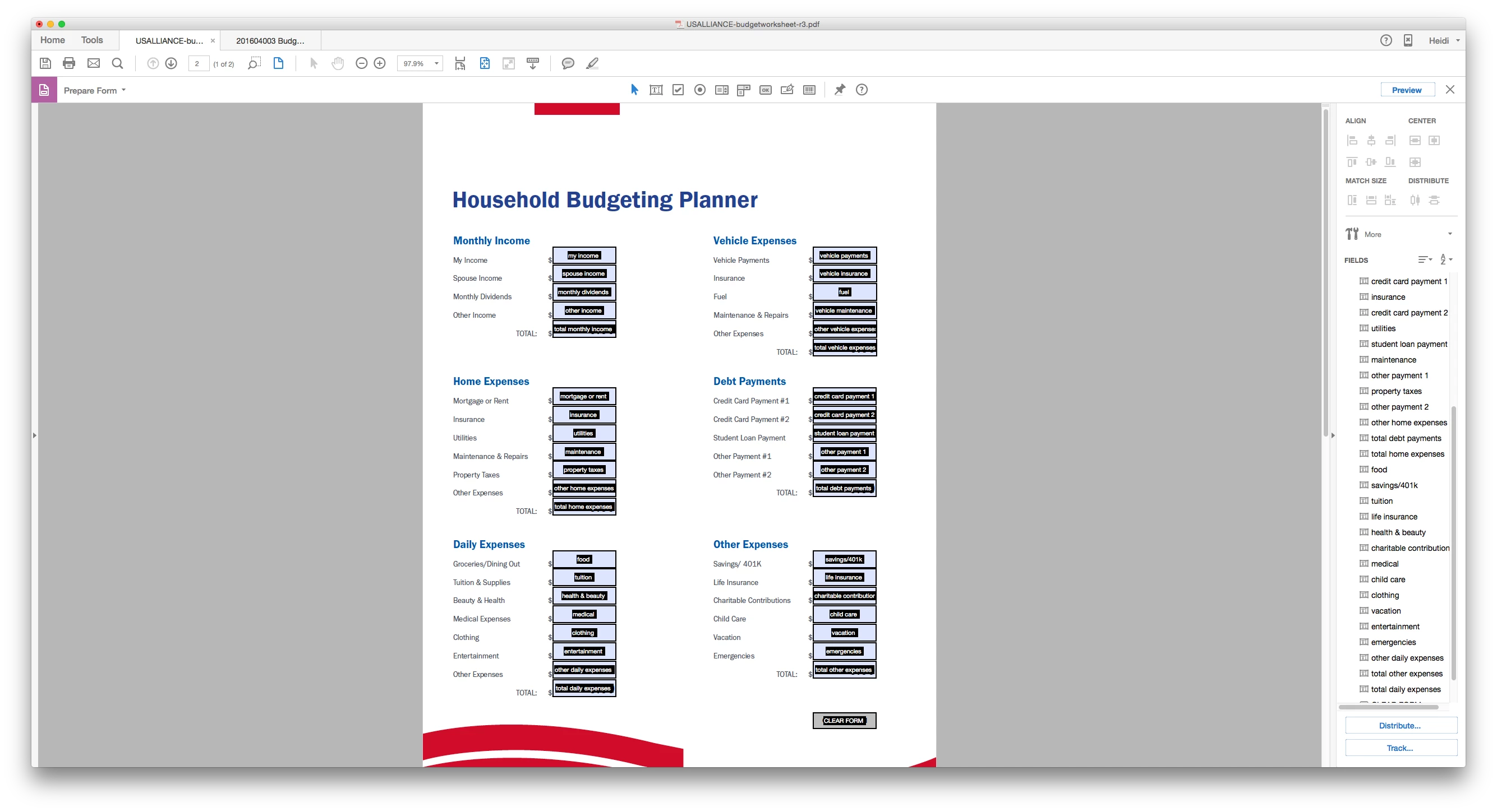

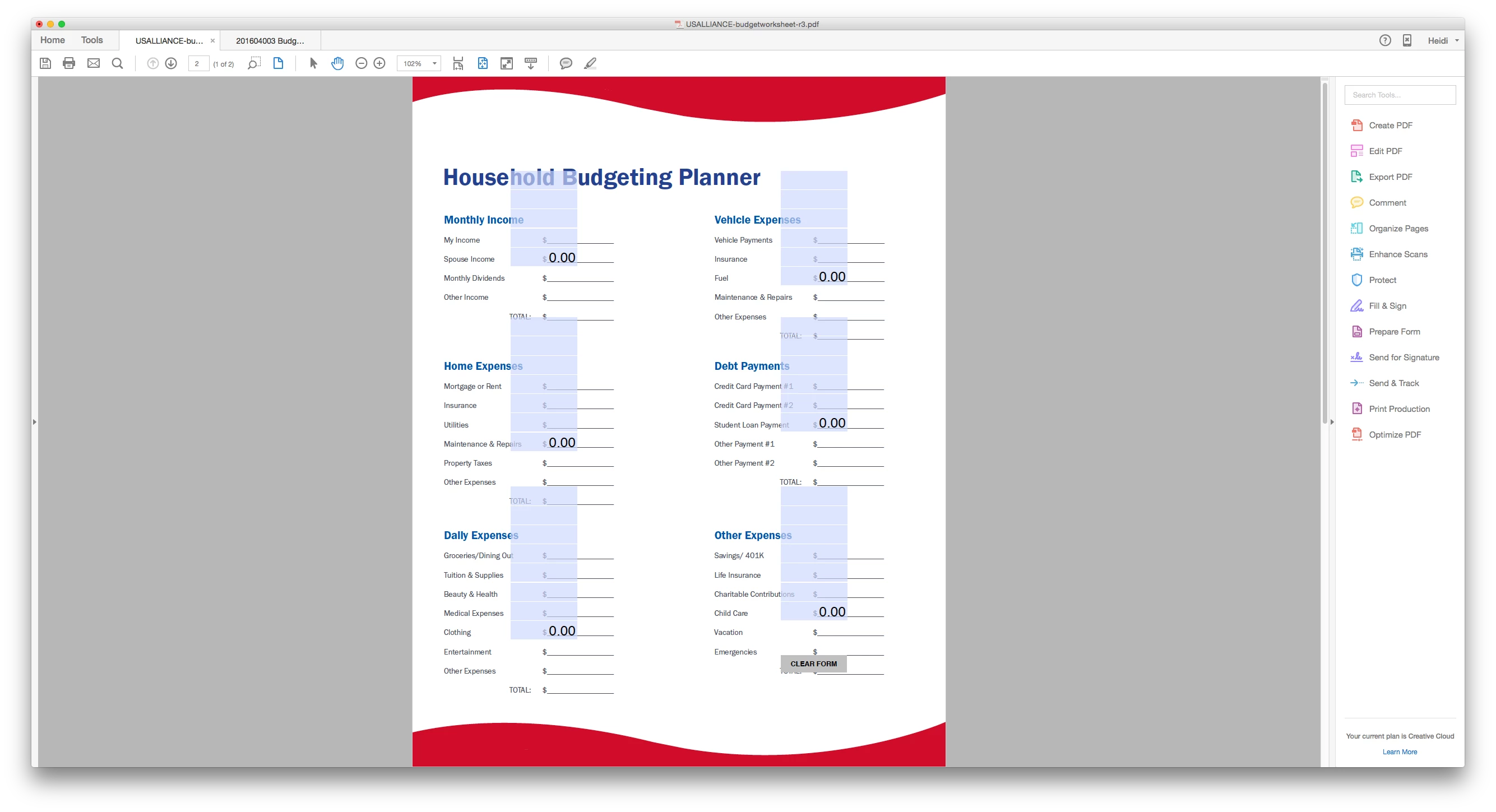

Unfortunately, yes. I have also tried deleting all the fields to see if the graphics return and also copying all the fields and pasting them onto a fresh PDF where the graphics are good and nothing works. In fact, when pasting the fields onto a fresh PDF, I get this result:
Then as soon as I move the fields and click off into the gray pasteboard this happens:

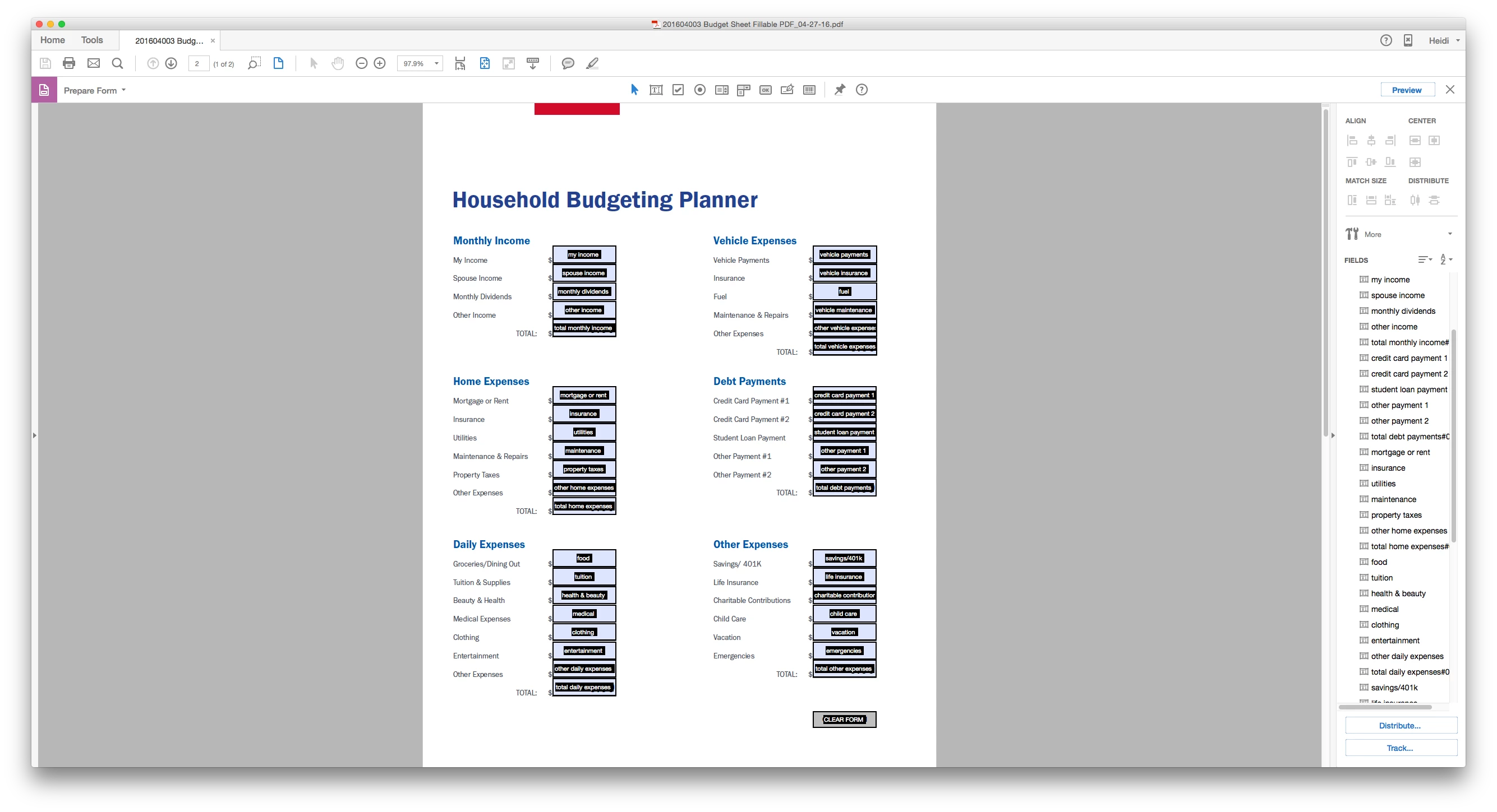

Here's the form before adding fields.
Here's the page after adding fields.
