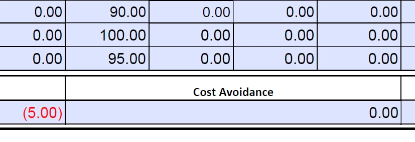

Scenario 1
nHTotal = 90
nFAve = 100
nFPrice = 95
The expected result is -5 on the savings formula and +5 on the avoidance formula - I am getting a 0 on the avoidance formula.

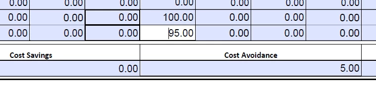

When I enter just a nFAve and a nFPrice value I am getting the net result so the formula appears to be half working, half not:
Any thoughts?
