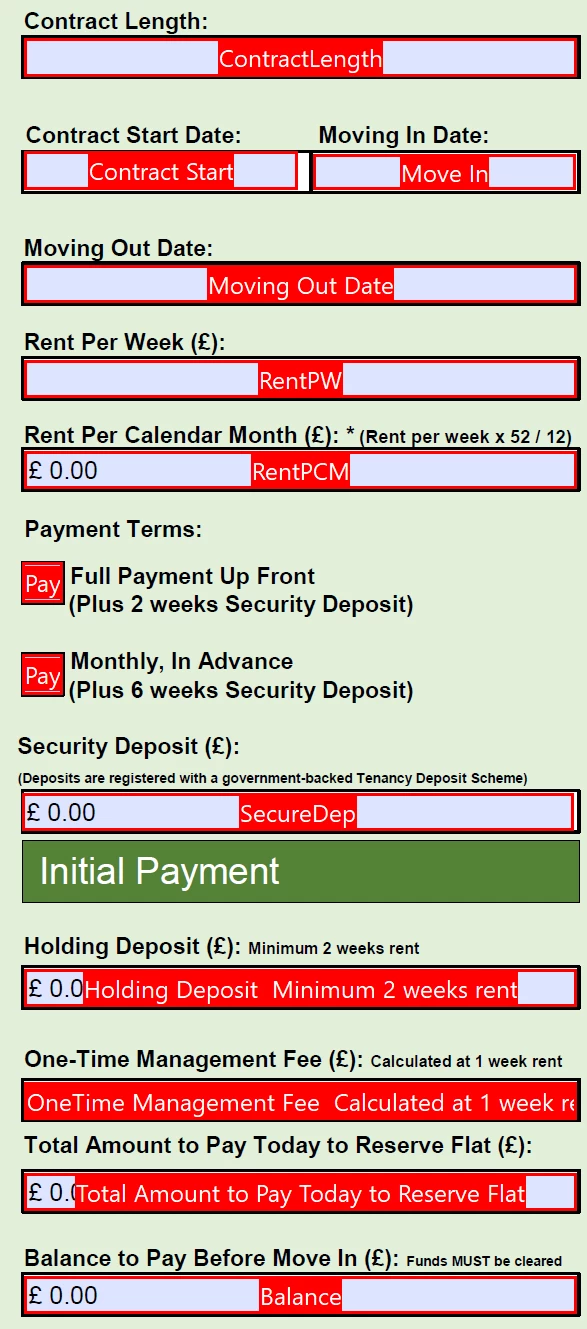

I am attaching a screenshot of the form, basically the only fields that are manually inputted are ContractLength (length of contract in months) RentPW (rent per week) and SecureDep (security deposit) - the idea is that the form will self-populate itself based on the three manual entries.
Just in case you need to see the actual form it is here: Dropbox - Test Booking Form.pdf ​
Thank you so much for taking the time to help

The field "Group 1" doesn't exist in the form.
