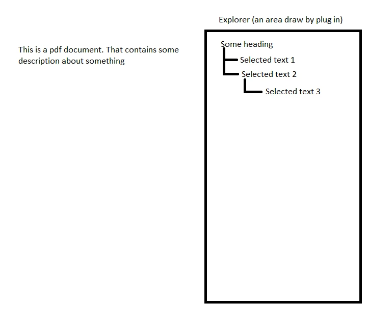

I don't want to edit file. I file to select some text from file and when user finishes the selection (for example he select two words) then I want a context menu to open with few options. And when user click on any option then selected text becomes the part of tree view. Something like below
I want to save this tree view in the pdf header or somewhere else. So that if user wants to open the document again then tree view is visible. I will explore platform API as well.
