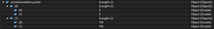

What I am trying to do at the moment was what I thought to be very trivial but is proving to be a confusing exercise. I simply wish to create a new annotation that is a line and set the points property to a specific value. When the object is initialized and set to "Line" type I can read the default points property, which it's value and datatype during debugging are as follows:
So I tried a very simple assignment operation for testing by doing the following:
