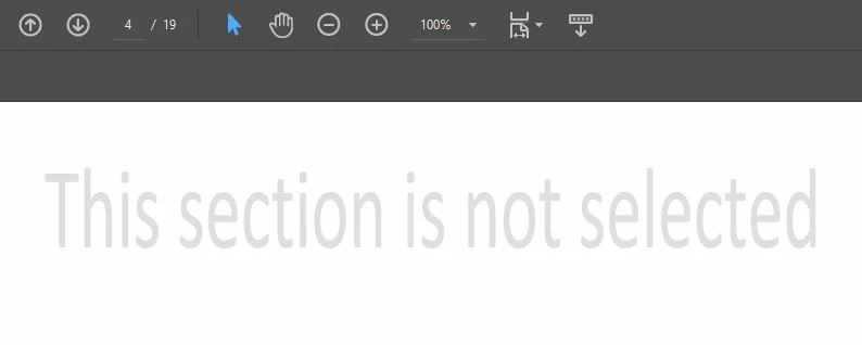

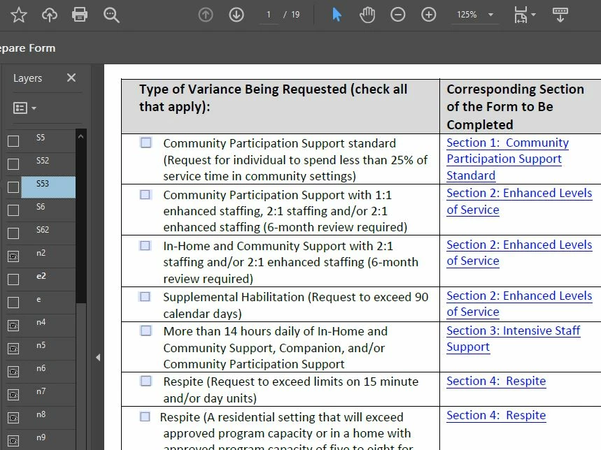

Thank you both for your help! I did add that space after var, and the layers are now toggling on and off. However, I'm experiencing an issue with deselecting. When a box is deselected, it hides all other layers, even though they are not specified in the Javascript. I'm not sure if I can share the form directly, but the below is how I have it looking.
Thanks for the suggestion try67! Unfortunately, I have two layers for each page. One should always show if that section is not selected. They wanted a visual indicator for blank pages if a section is not selected, so I will have an initial state which shows those layers.
Main page of form. The initial state should have page 1 and all n# layers shown. Upon selecting a checkbox, it should show all s# layers and fields associated with that section and turn off n# layers.
If not selected, the n# layers show the following text.
If selected, then s# layers and fields for that section will show.
Thank you again for taking a look, and I'd appreciate any further help!
