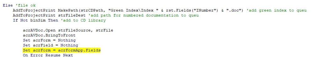

When I ignore this error, the program starts copying and renaming PDFs, but does not add the text box to them. Each PDF results in the following error:
Error number 91:
Description: Object variable or With block variable not set
which points to this code:
Curiously, the whole process works when:
  • At least one of the destination PDFs has been created and is opened in Acrobat DC when I press the button (this will create all destination files and add text boxes to all but the opened file); or
  • The first source PDF file to be used is opened in Acrobat DC when I press the button (this creates all destination files with text boxes)
Can anyone explain this behavior? Full code below. The button executes BuildQueu (blnSim = false). The snippet that should add text boxes starts from the second image.

                                        If Not blnSim Then 'add to CD library
                                            acrAVDoc.Open strFileSource, strFile
                                            acrAVDoc.BringToFront
                                            Set acrForm = Nothing
                                            Set acrField = Nothing
                                            Set acrForm = acrFormApp.Fields
                                            On Error Resume Next

                    If intRecordCount > 0 Then
                        rst.MoveFirst
                        If blnSim Then
                            strCDPath = strSimPath
                        Else
                            strCDPath = MakePath(strProjectPath, "CD_" & strMachineNumber, txtCFolderCDManual, txtCFolderCDCert, txtCFolderCDExp)
                        End If

                                        AddToProjectPrint strFileDest 'add path for numbered ex cert queu
                                            'AcrobatField rst.Fields("INumber"), "Num", "text", "48", 520, 20, 590, 70 'JVB
                                            AcrobatField rst.Fields("INumber"), "Num", "text", "48", 500, 20, 590, 90 'JVB
                                            Set acrPDDoc = acrAVDoc.GetPDDoc
                                            acrPDDoc.Save PDSaveFull, strFileDest
                                            acrAVDoc.Close True
                                        End If

Jan 8, 2020 9:20 AM UTC
My, that's a lot of code. Nobody's going to read that, for sure...
Anyway, please check on the problem machine: what is your exact Acrobat version (not "latest" please)? And, is it Acrobat Reader, Acrobat Pro or Acrobat Standard?
Jan 8, 2020 9:21 AM UTC
Hmm, also... does it work if you have already opened an ENTIRELY UNRELATED PDF in Acrobat?
MHE1Author
Jan 8, 2020 9:26 AM UTC
It does not, the same sequence of errors occurs and I get no text boxes.
