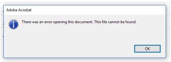

When this is used we see an Acrobat dialog that tells us that a file cannot be found:

Invalid Location "/C/Users/itproudfoot/AppData/Local/Temp/CIMP000102231_EN.word.pdf". File or folder does not exist.Exception in line 23 of function trustedSave<, script Folder-Level:App:save2word.js
[save2word] unable to process: /C/publiframe/api/pdf2word.txt
message: Security settings prevent access to this property or method.
extMessage: NotAllowedError: Security settings prevent access to this property or method.
App.openDoc:23:Folder-Level:App:save2word.js
fileName: Folder-Level:App:save2word.js
lineNumber: 23
number: 11
columnNumber: 0
Despite the error message the Word document is created correctly on my system. On the client's system and our test system the output fails.
