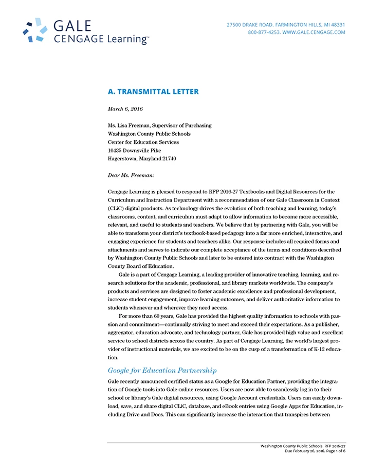

  • When we view a test document I created on screen in MS Word, there are 3 lines of text at the bottom of the page after a subheading. (see attached JPEG Word screenshot)

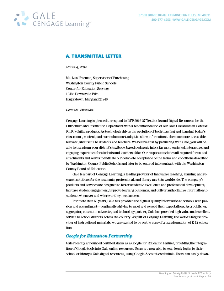

  • When you print that document to either Adobe PDF as a printer or to any paper laser printer, there are suddenly 5 lines of text at the bottom of the page after the same subheading! And more bizarre, every single line on the page has the exact same line ending (even hyphenated words are identical).

  • JPEG of the Adobe PDF showing different line
SCREENSHOT FROM WORD:
JPEG of the file made through the ADOBE PDF printer driver:
