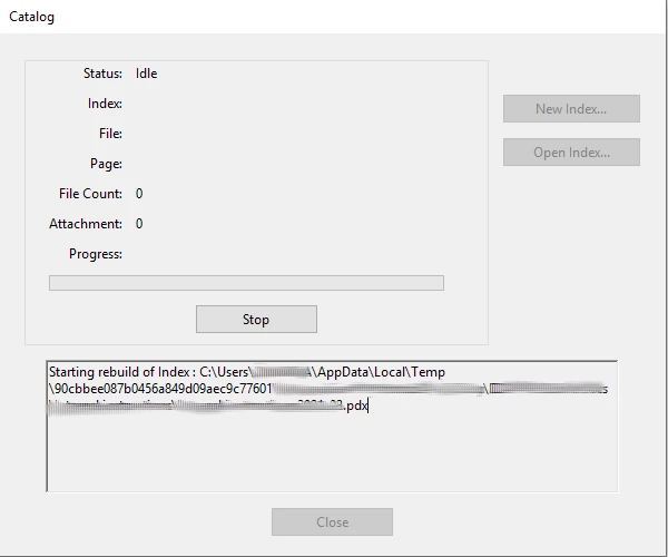

Apr 15, 2021 12:49 PM UTC
Hi @adeep93
Thank you very much for getting back to me.
I first had to create the "FeatureState" key under "HKEY_LOCAL_MACHINE\SOFTWARE\WOW6432Node\Adobe\Adobe Acrobat\DC\" as it didn't exist.
I then added the "bFallbackOnix32" DWORD value as described.
Then I ran the script again. Now the index rebuilding process window shows:
"Starting rebuild of Index : C:\Users\...\My index file.pdx"
But the process never even seems to start. It is stuck on "Status: Idle", as you can see in the screenshot.
Before, the process was successfully counting all files, and then it would fail upon trying to index the first file (while it was working fine when doing the same operation through the GUI).
With the registry fix in place, it does not even count the files.
