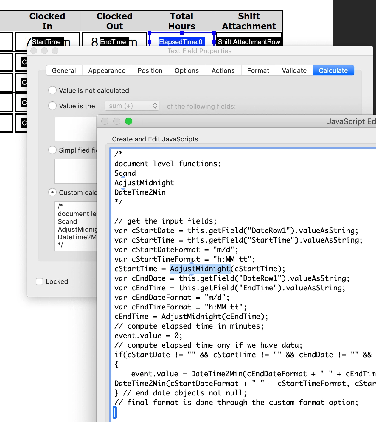

I am having so much trouble calculating the time between the "clocked in" and "clocked out" times. I need this total under the "total hours".
If someone could please help me figure out the first row under "recorded shift," then I can copy & paste the rest.

You certainly copied the scripts from an other file.
This file must include document level functions which are called in your script, so we need these functions.
Could you please share the file with document level functions.

If you are very new to scripting means you didn't write the scripts included in your document!
These scripts use 3 functions such as "AdjustMidnight()" for example.
These functions are often placed in document JavaScript level but are not included in your document.
They must certainly be included in the original document from where you copied/pasted the scripts.
So it should be great if you share this document. That would evoid to re-write all the scripts...
