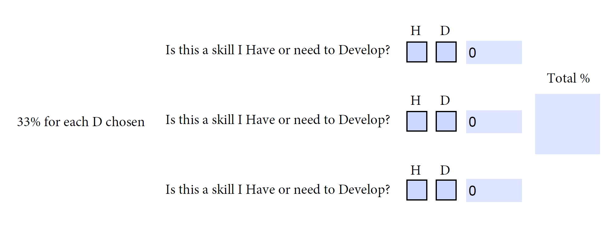

What our team would like to do here:
A user chooses if they Have or Need to Develop a skill. Each H chosen passes a 0. Each D chosen passes a 1 and calculates the % total. 0/33/66/100 is possible. Each H and D need a different box name, like Have1 and Develop1 and so on through possibly 300 skill levels.

The checkbox names should be equal, because otherwise the checkboxes can be chosen simultaniously.
You can give them different values when checked however, see the example attached for a rough example of what you're looking for.

William225192357fw1
Jan 6, 2022 5:33 PM UTC
Adding this in for assistance
