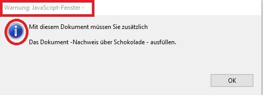

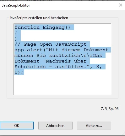

With a lot of effort and patience from George_Johnson  I wrote the script which can be seen in the first picture.
Now I would like, if this is possible, to change the title of the window (see picture 2).
At the same time I would like to ask if I can replace the info sign (red circle) with a jpg picture of mine (not me:-).
Thank you in advance for any help.
Nikolaos.
try67
Nov 5, 2020 9:25 AM UTC
No to both. If you want to include a custom image you will need to use a dialog object, which is MUCH more complicated to write.
And you can't get rid of the warning part of the title, unless you run the script from a trusted context (eg. a script on the local machine). You can, however, add some text to it by adding an extra parameter to the end of the alert method, like this:
app.alert("some text", 3, 0, "my title");
