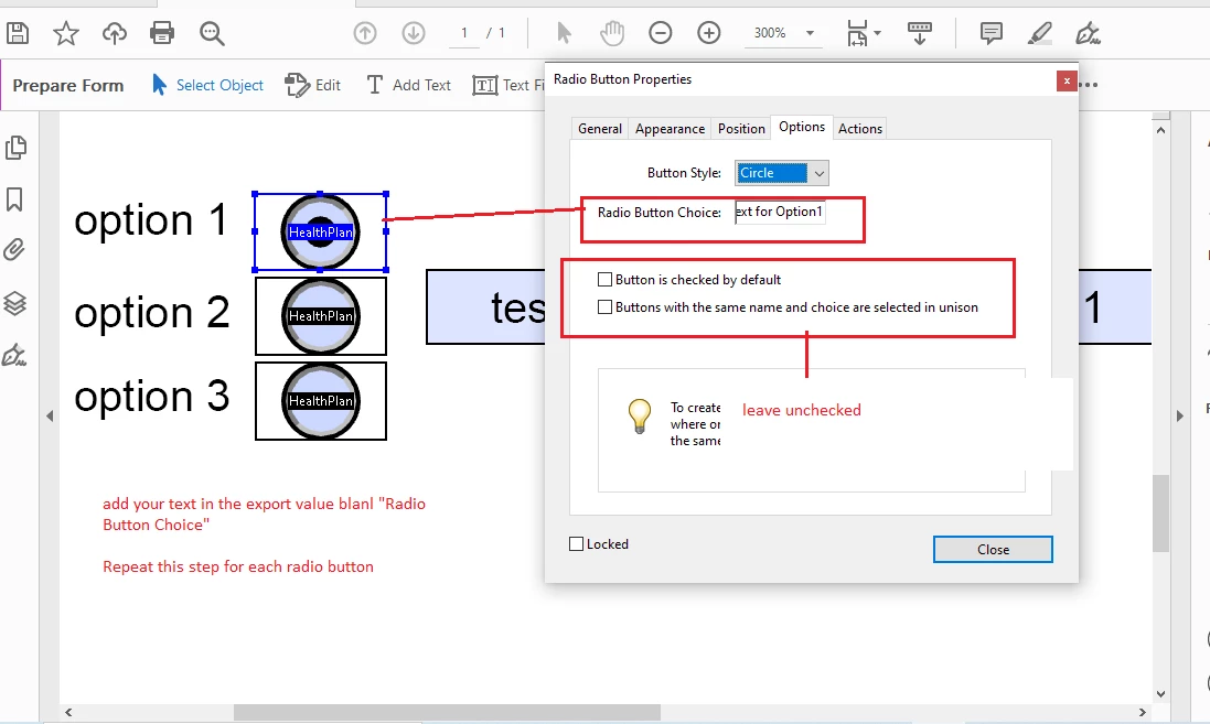

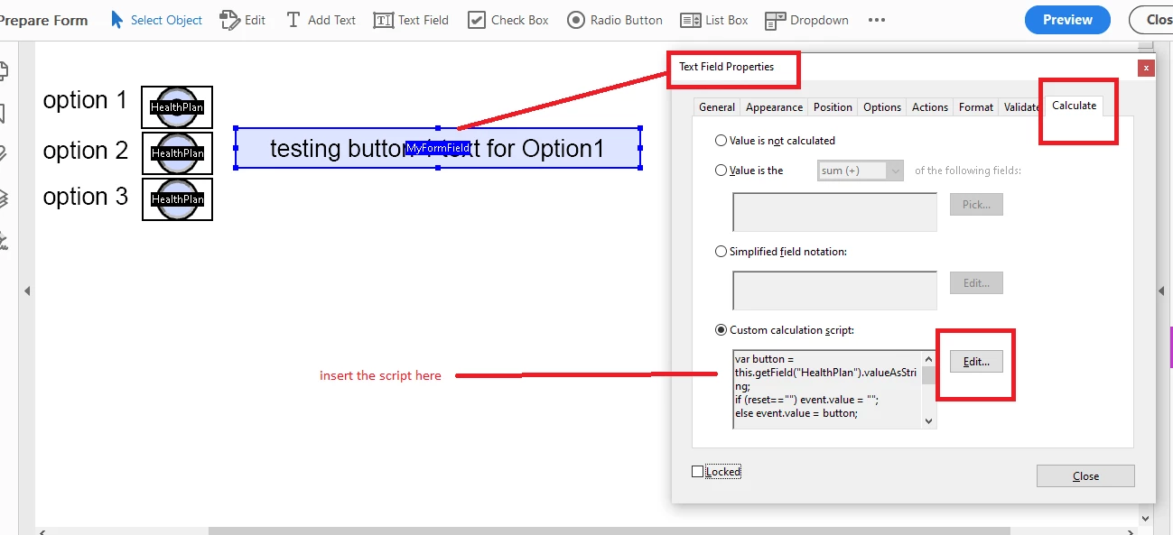

ls_rbls
Nov 13, 2019 12:33 PM UTC
You need to rename each radio button with the same fieldname. Just change the name to "Button" for each radio button, for example. But add a unique export value for button 1, button 2, and button 3 respectively.
Type in the text that you want it to be displayed in myFormField as the in each of the radio buttons' export value.
To do this, in Edit mode, right click on the radio button(s), select Properties---->>> Options and type in your text in the provided blank for the export field. Make sure to uncheck the option that says button is checked by default.
Then in myFormField textfield open field Properties, goto the Calculate tab, and add a script as Custom Calculation script like this:
var button = this.getField("Button").valueAsString;
if (button=="") event.value = "";
else event.value = button;

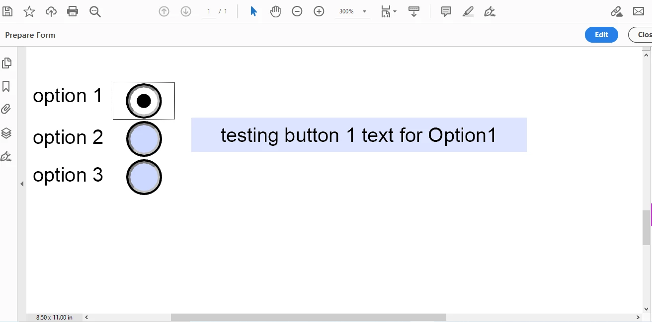

ls_rbls
Nov 14, 2019 5:34 AM UTC
Yes, I apologize. I made a mistake.
Use the code like this:
var button = this.getField("HealthPlan").valueAsString;
if (reset=="") event.value = "";
//if you need to clear or reset the radio button selection after the user ticked on one of the option add this line at the end. Remove the slashes // if you are using it
//this.resetForm(["HealthPlan"]) ;
//The script above was taken from here https://answers.acrobatusers.com/clearing-marked-radio-buttons-form-q1600.aspx
Also review the slides below:
