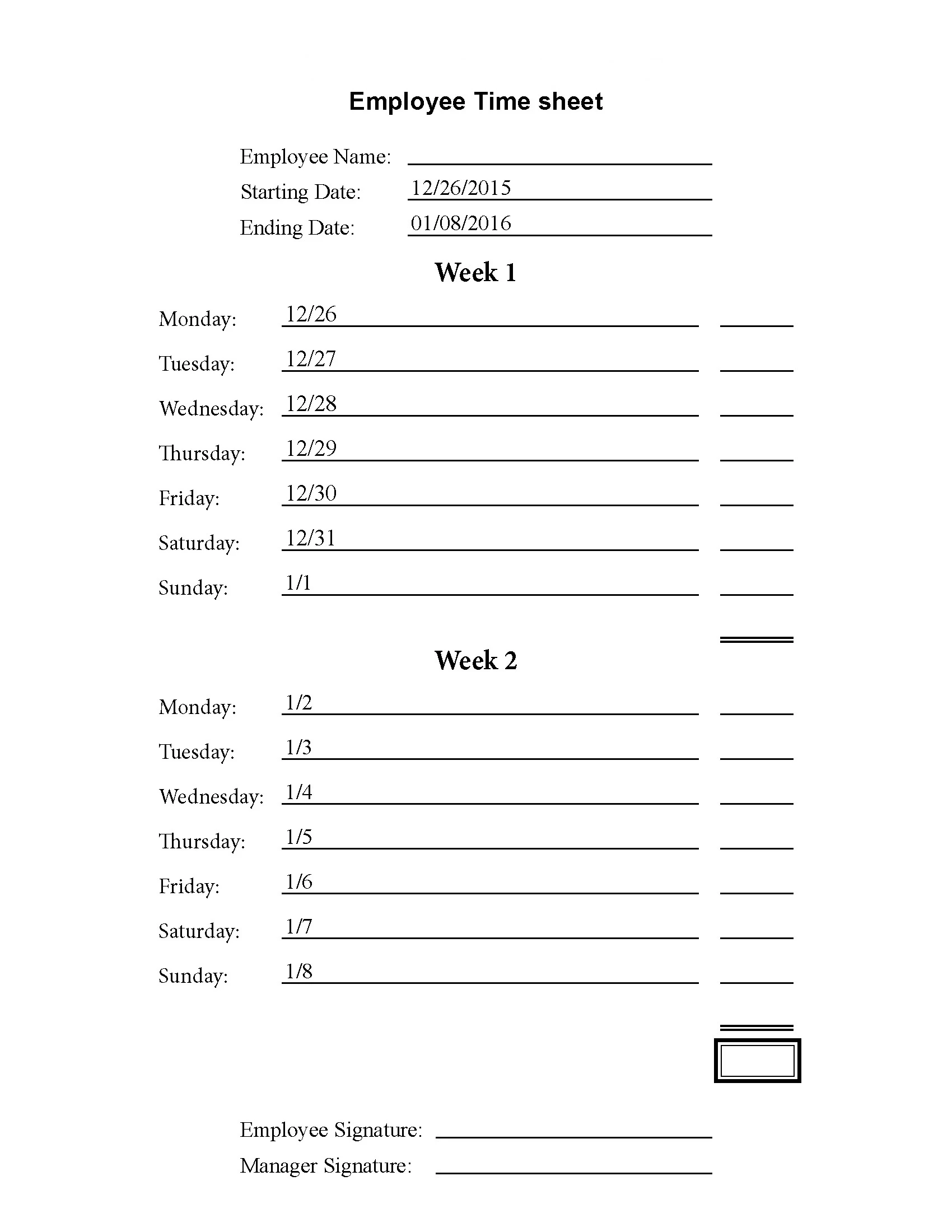

I have a time sheet form that I've copied 20 times. Only one field in the forms is different - the Name. Each name's form field is labeled "Name1", "Name2" etc. I had to create extra pages so that whoever is creating these sheets in the future will be able to add names when necessary, but these fields are blank for now. I don't want these extra pages to print and I'd rather not force the person printing the time sheets to have to check how many to print every time. Is there a way to check if a 'numbered set' of form fields is blank and set them to not print? This form field also happens to be the first field on each page if that helps. I have included an image of the sheet below. Thanks!
