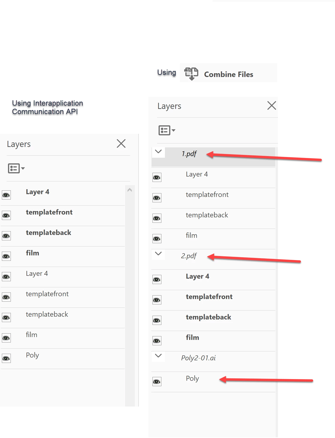

I am looking to combine multiple PDFs using the "Interapplication Communication API Reference"
The below snippet will combine the documents and preserve the layers it won't give the same results as creating a binder using the UI combine documents button
The difference being 1) The combine button creates layers for each PDF document and with the document layers created as sub layers whereas the snippet just created the doc layers without the parent layers as per document name. 2) The button automatically creates bookmarks for each document, the snippet doesn't.
Any ideas how to at least get point 1 working. It's for windows and either powershell or vbs would be easiest.
Edit: I see the bottom red bottom red arrow is in the wrong place so please use your imagination to put it in the correct place 🙂

Bernd Alheit
Bernd AlheitCorrect answer
March 12, 2018
For this you must create layer groups. May be not possible with IAC.
Bernd Alheit
Bernd AlheitCommunity ExpertCorrect answer
March 12, 2018
Trevor:
Trevor:Author
March 12, 2018
Thanks, from the SDK docs if don't see any reference to layers so you're probably correct.
lrosenth
Adobe Employee
Adobe Employee
March 13, 2018
Yes, the IAC methods don’t have the same support for layers/OCGs that the plugin APIs do
