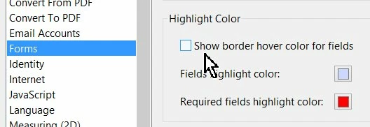

You can see the colors when you disable the form highlighting in the preferences:
