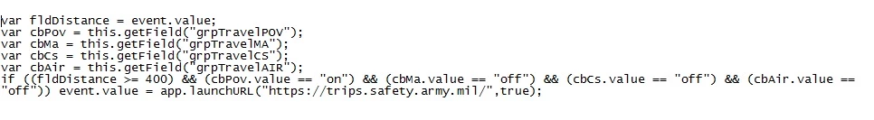

So I did what you said, the result was I was always getting the warning message, so I did this:
[I guess I can't paste anything into here]
