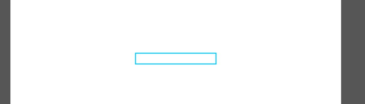

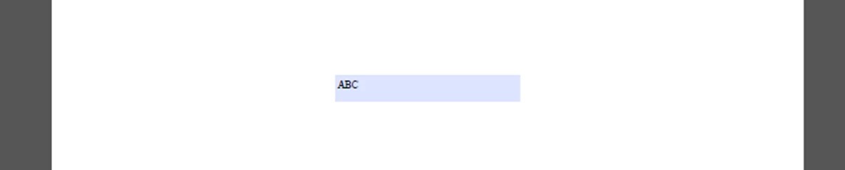

Nov 18, 2016 3:13 PM UTC
Text field value is not showing. See the below screenshot.
Page 1:
Page 2:
vigneshs53970460
Nov 18, 2016 2:40 PM UTC
If suppose they have entered some value in the 2nd page. it will come not come, when I again spawn from the template.
I need a copy of second page.
try67
Nov 18, 2016 2:45 PM UTC
You can use the insertPages command to insert a page from a file into itself.
For example, this command will copy the first page of the file and insert it as the last page:
this.insertPages(this.numPages-1, this.path, 0)
