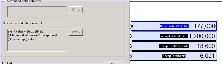

I have 6 fields with property value and 6 related % Ownership, then a grand total field.  My intent is to take property_1 x ownership = value, do the same for the remaining 5 properties, then add all resulting values for a total property value based on % of ownership.  I first entered script below with only one property (without the surrounding ()'s, and it worked fine, then I added the (), copy/pasted the same script & updated the names.  When I inserted the remaining properties, it doesn't work.   (Note, in the example below the calc would be $300,000 X 59% = $177,000).  Where did I mess up on the script?
Thank you so much ~ Michelle
event.value = ( this.getField("MarketValue").value * this.getField("Ownership").value ) + ( this.getField("MarketValue_2").value * this.getField("Ownership_2").value ) + ( this.getField("MarketValue_3").value * this.getField("Ownership_3").value ) + ( this.getField("MarketValue_4").value * this.getField("Ownership_4").value ) + ( this.getField("MarketValue_5").value * this.getField("Ownership_5").value ) + ( this.getField("MarketValue_6").value * this.getField("Ownership_6").value );

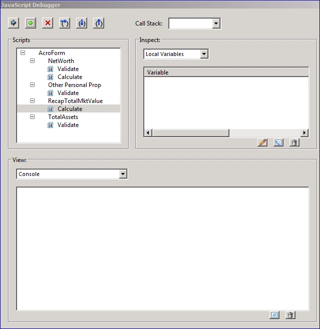

Thank you for your help.  I tried adding in each section of the query one at a time and it all worked, until I added in property #3.  Not sure how to read the debugger, but it also pointed to #3.  After close review, I found that I had a space in field name between Market and Value, which was different than the rest of the fields.  Fixed that and it worked.  What I learned is to used the debugger to guide me.  thank you soooooo much!

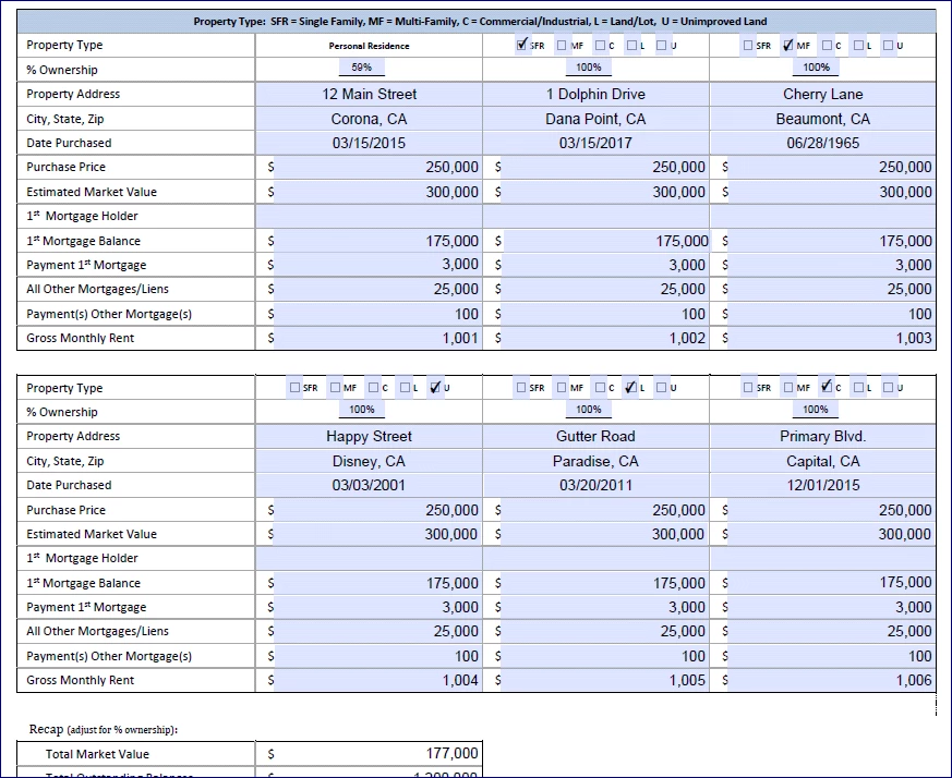

It does not produce the result I expected.
1     300,000X59% = 177,000
2     300,000X100% = 300,000
3     300,000X100% = 300,000
4     300,000X100% = 300,000
5     300,000X100% = 300,000
6     300,000X100% = 300,000
When I only had the first property in the query, it returned a result of 177,000 which is correct answer.  When I added in the next 5 (as shown in my original question), I expected to get a result of 1,677,000.  However, the field did not update.    Is there a better way to write the script? Maybe like a weighted value like in Excel?
I'm still new at this and haven't used the debugger before.  I had to activate it, but don't know if its telling me anything
