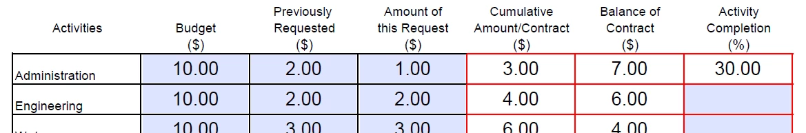

In the Completion field i have entered a simple formula to get the percentage to display.  The formula is (CumulativeAmount1/Budget1)*100 by the way.  the math works correctly but the problem i'm having now is that when the first 3 fields in the row are left empty it just blows up and gives me the "Value entered does not match the format of [Field]" error.  i'm looking for a fix for that.  i'd also like for the fields to remain empty unless a value is entered into any of the first 3 fields in the row.
i have zero skills at this.  all i know are the basics of Excel formulas so please forgive my ignorance.
any help would be appreciated.

i was with you up until you started talking scripts.  i understand what they are for and i was able to follow it for the first line but after that it's just way beyond what i can understand.  i have only taken one C++ class and that was nearly 15 years ago and i was horrible at it.  i dont even know where to being with what you gave me.
i dont need the completion column to display a percentage, just a number to 2 decimals.  which i have it doing.  is there a way to make the field only be seen and active when values have been inserted into the fields in it's formula?  or get it to display a "-" like excel does?
