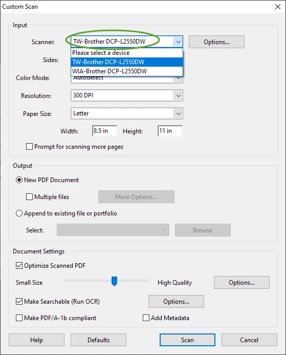

I went to Document's tab selected custom scan and it allowed my the option to change the scanner and select the correct on as by default it was not recognizing the connected scanner. Hope this helps

1) Open Adobe Acrobat
2) File --> Create --> PDF from Scanner --> Custom Scan
3) Select the correct scanner and click scan.
4) Scan a file.
5) your default scanner is changed to the new selected scanner.
