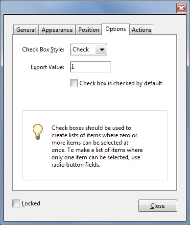

Go to the field's Properties, Options tab, and set the value as the Export value, like this:
It has a slightly different name for a radio-button field, something like Radio Button Choice, but it's pretty much the same thing.
