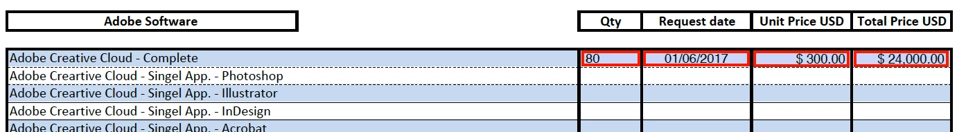

I created an interactive fillable form, some fields should be filled by hand, calculations was done in Acrobat Pro to automatically displayed formula results.
Here is what is expected to happen in the red framed fields:
  1. QTY.: User will type-in the quantity being requested
  2. Requested date: User will type-in the request date (see #4 below)
  3. Unit Price: User to type-in Unit price
  4. Total Price: is an auto calculation. If "Request date" is 1st of June, then formula is as follows [ Qty x Unit Price ]. If the date is not 1st of June then formula should be as follows [ Qty x Unit Price / 2 ]
How can I make the Total Price to use If/Then formula, must this be scripted?

Thank you both @Bernd Alheit and try67​ for jumping in with the script. Unfortunately I'm getting this error after adding ".valueAsString"
The error reads: SyntaxError: missing ) after condition.
Below is the script I entered.
event.value = this.getField(" ??QTY. Adobe CC complete?? ").value * this.getField(" ??Unit Price Adobe CC complete?? ").value;
if (this.getField(" ??Request date?? ")  ".valueAsString" != "01/06/2017") event.value = event.value / 2;
Try this code:
var v = Number(this.getField("QTY. Adobe CC complete").value) * Number(this.getField("Unit Price Adobe CC complete").value);
if (this.getField("Request date").valueAsString!="01/06/2017") v = v/2;
event.value = v;

You must use JavaScript for this:
event.value = this.getField(" ??Qty?? ").value * this.getField(" ??Unit Price?? ").value;
if (this.getField(" ??Request date?? ") != "01/06/2017") event.value = event.value / 2;
In the code you must use the correct field names.

Yes, this is the right place, and yes, this can be done using a script.
What format is the date field using?
Zaid Al Hilali
June 20, 2017
Qty and Unit Price fields are numbers only, while the Request date is dd/mm/yyyy
try67
June 20, 2017
You can use the code given above, then, just add ".valueAsString" after this part: this.getField(" ??Request date?? ")
