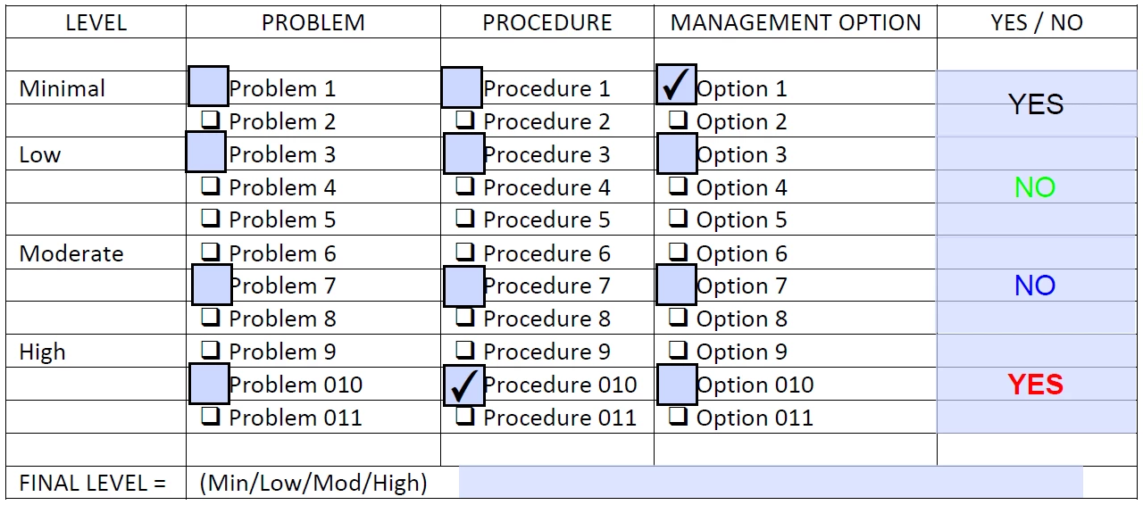

Below is a screen shot of the planned form:
INFORMATION ABOUT THE FORM:
  1. Need to be able to check off all that apply – for example a typical response might be POSITIVE
         for:  Problem 1; Problem 5; Procedure 6; Procedure 10 and Option 10.
         (All of these POSITIVE).
  2. For Calculation of the “FINAL  LEVEL” – this relies ONLY on the single HIGHEST Problem – or Procedure –
         or Management Option.
  3. In the case above – the Final Level would be HIGH because both Procedure 10 AND Option 10 were POSITIVE.
  4. The YES / NO field could be used to indicate that ANY of the responses at that particular level had
         been selected.  (This is not completely necessary – but would make it easier to see at a glance where
         the highest level had been met.)
  5. In another case where responses showed POSITIVE for Problem 6, Procedure 1, and Option 1 – the FINAL
         LEVEL would be calculated as MODERATE – because the Problem 6 was POSITIVE.
  6. QUESTIONS:
    1. What type of “check box”  or “text box” should precede the Problems, Procedures, and Options?
    2. How to script for a binary answer for YES / NO – either ANY of the fields in that level have
            been selected – or NONE of the fields in that level have been selected –
            i.e. 1=YES; 0=NO
    3. How to script the “FINAL LEVEL” box to choose the HIGHEST LEVEL that had a POSITIVE (YES)
            response.
    4. Again – it does not matter whether 1 or ALL of the fields at a particular level are selected –
            ANY fields return a POSITIVE for that level.  (It would merely be “helpful” to see
            what had been chosen as POSITIVE at each level.)
THANK YOU to anyone who could give me some help/advice on this.

For some reason, I am not able to get the "FINALLEVEL" Text Box to populate with anything.
Everything else seems to work fine.
Here is a screen shot of the first-pass draft.  As you can see - a CHECK in any of the boxes converts the YES/NO to YES. (PERFECT!)
But, there is nothing in the FINAL LEVEL box.

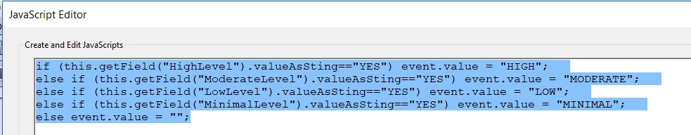

This is the script from the FinalLevel Text Box:
Below is the entire script

/*********** belongs to: AcroForm:FINALLEVEL:Calculate ***********/
if (this.getField("HighLevel").valueAsSting=="YES") event.value = "HIGH";
else if (this.getField("ModerateLevel").valueAsSting=="YES") event.value = "MODERATE";
else if (this.getField("LowLevel").valueAsSting=="YES") event.value = "LOW";
else if (this.getField("MinimalLevel").valueAsSting=="YES") event.value = "MINIMAL";
else event.value = "";
//</ACRO_script>

It seems fine... Are you seeing any error messages in the JS Console (Ctrl+J)? Are there no results at all, or are they incorrect?
If the latter, check the field calculation order.
Also, do not edit the code in the Edit All JavaScripts window. It's a recipe for problems. Only edit it under the field or the doc-level script.
Perfect.
Got it working.  Thanks again!
