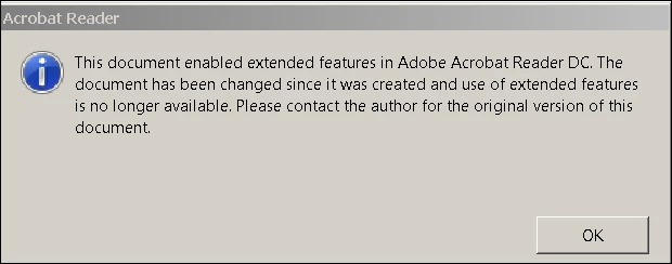

I created a form in Acrobat Pro XI. Since Acrobat XI uses FormsCentral, I saved it as a pdf. It works as an interactive fillable form in Acrobat XI where it was created.
When I open it in Acrobat Reader DC, I get this message:

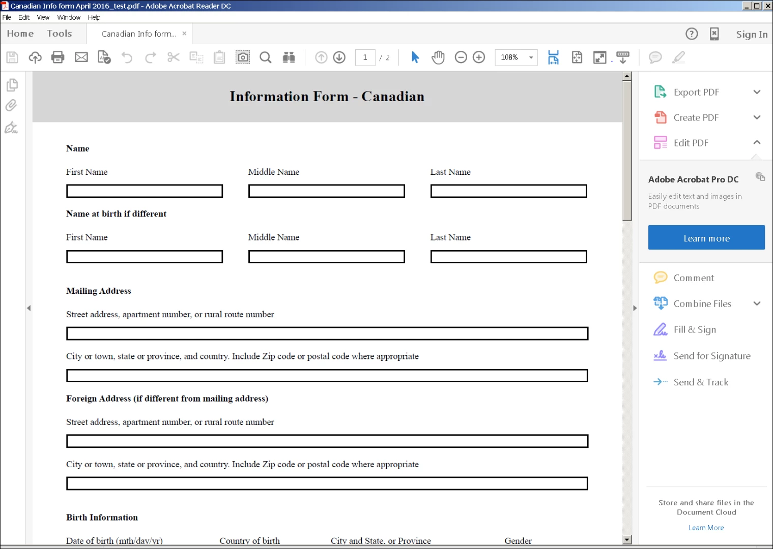

I know a similar question was posted in February. I've read through the entire thread - it turned out she was not actually using Acrobat - something else was opening the form. I checked and I am using Acrobat - here is a screen shot:
I checked and it is a reader enabled form. Was there something else I should have done in Acrobat XI FormsCentral to be sure this will work? I know this Forms Creator is no longer supported in terms of collecting data, but I thought it would work to create the forms.

There are a number of reasons that message can appear, many of which are difficult to diagnose, especially without being able to examine the file. A simple reason is the date/time on the machine that generated the PDF is wrong and set to some time in the future. An easy fix if the form doesn't need to be Reader-enabled is to remove the usage rights by selecting: File > Save a Copy
in Acrobat. Note that this message can also appear when the file gets corrupted or is somehow invalid. This is what's difficult to diagnose, but with Acrobat Pro you may get some clues using Preflight, which can report on syntax problems. Problems with fonts is another potential source.

Preflight is a feature of Acrobat. Reader doesn't see the form because there's something wrong with the file. I can't say more without looking at it. Here's something you can try though:
1. After you export from FormsCentral to PDF, open the file in Acrobat and select: File > Save a Copy
to save it to a new file.
2. Open this new file in Acrobat (it doesn't open automatically) and confirm that it works OK. Also, test this new file in Reader to see what happens with it.
3. If it works OK in Acrobat and Reader, you can then Reader-enable the form in Acrobat: File > Save as Other > Reader Extended PDF > Enable More Tools
Note that users with Reader 11 and DC are able to fill-in and save non-enabled forms. So it's really only necessary to Reader-enable if some of your users have older versions (pre-11).
