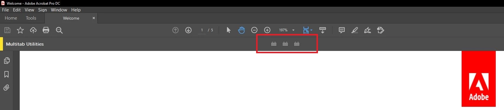

I'm getting an "Unhandled exception at 0x772ECE50 (ucrtbase.dll)" when I run my plugin. I need to add 2 buttons in a flyout toolbar attached to the main Toolbutton but I always get that error.

I make some tests creating another project with just the flyoutToolBar code (the same code above). I compiled the .api plugin and tested it on another fresh computer (Acrobat DC Pro 2020.012.20048 and windows 10 Pro 2004) getting the same result. Once I place the .api and execute Acrobat DC, two things may happen: 1. it just doesn't run OR (rarely) 2. it runs but it does not show the correct button arrange. When I run the debugger is when I get the ucrtbase.dll error.
