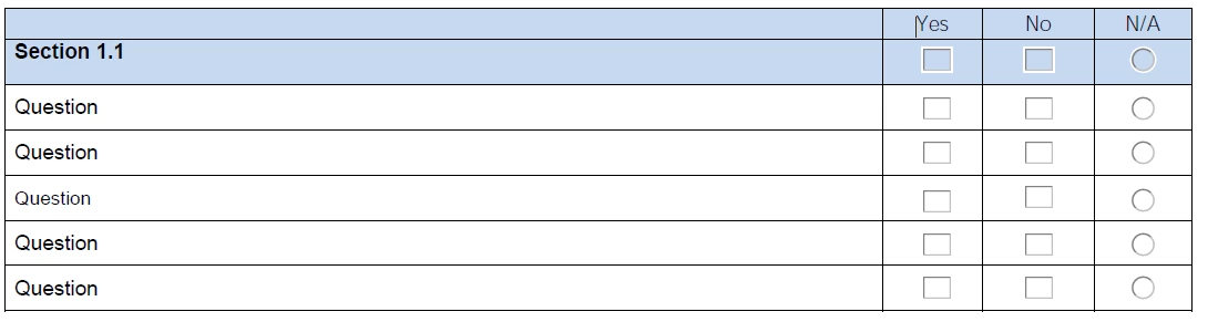

I have a form in Adobe XI with a number of grouped radio buttons, if a user selects N/A on Section 1.1 I want all the subsequent questions in section 1.1 to auto populate the N/A radio button but if Yes or No is selected they should be able to select a radio button on the other questions.  Ideally, if N/A is selected they should also see a message telling them to go to the next question.
My form will look something like this
Section 1.1 - If N/A is selected all other questions in the group will all populate with N/A and a message will appear telling the user to go the next Section.  Alternatively if Yes or No is selected the user should select a response to the other questions.
Can this be done? I'd appreciate help on this one, I'm still a novice but have picked up some really useful information on this forum.

BarlaeDC
Jun 8, 2018 11:53 AM UTC
HI,
I would like to check the functionality you want to make sure I am understanding the result you need correctly.
In the form you have control questions and questions that are controlled.
CONTROL QUESTION - GENERAL PREMISE INSPECTIONS
This has the option of 'Yes' and 'N/A'.
If you select 'Yes' all questions of that section should be enabled.
If you select 'N/A' all question of that section should be disabled and controlled questions should be set to 'N/A'.
There is no 'No' Option.
CONTROLLED QUESTION - Are these inspections recorded and help on site?
This has the option of 'Yes', 'No', and 'N/A'
If you select 'Yes' nothing happens to any other field
If you select 'N/A' nothing happens
If you select 'No' nothing should happen - IS THAT CORRECT?
If the above is correct, then you need to remove the code from all the 'No' check boxes as it is not needed. The control question is the only one that requires the code to be applied.
If I have a mis-understanding, please respond with corrections and I will re-evaluate my answer.
Hope this helps
Malcolm
EllenBCCAuthor
Jun 8, 2018 12:04 PM UTC
You've summed that up perfectly.
I thought I'd deleted the code from the No box but obviously hadn't.  Just tested it now with the code removed and it works as it should.  Thank you for taking the time to help.  I'll go and fix the other codes now ....
Ellen

BarlaeDC
May 25, 2018 11:44 AM UTC
HI,
You could create 2 functions, probably best to add them at the document level, they would need to be something like this.
[ Code slightly more verbose than it probably needs to be for clarity ]
function disableRadioButtons ( controlButton, controlledButtons)
    var controlBut = this.getField ( controlButton);
    if ( controlBut.value == "Choice3")
        for ( var i = 0; i < controlledButtons.length; i++)
            var controlledBut = this.getField ( controlledButtons);
            controlledBut.value = "Choice3";
            controlledBut.readonly = true;
function enableRadioButtons ( controlButton, controlledButtons)
    if ( controlBut.value != "Choice3")
            if ( controlledBut.value == "Choice3")
                // only if the NA option is selected do we unselect it.
                controlledBut.value = "";
            controlledBut.readonly = false;
Then from the "Mouse Up" event if the non-NA buttons, call this
enableRadioButtons ( "Group1", ["Group2", "Group3", "Group4"]);
from the NA buttons call this.
disableRadioButtons ( "Group1", ["Group2", "Group3", "Group4"]);
Each function takes 2 parameters, the first is the NA button to control the logic, the second is an array of all the names of the groups that you want to be controlled.
Hope this helps
Malcolm
