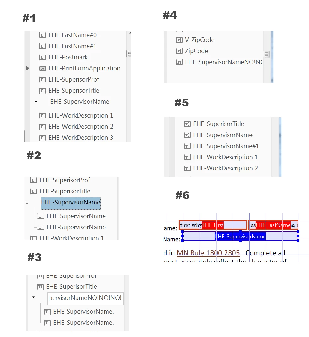

August 29, 2016
I haven't found a true fix for this in InDesign, but what I've discovered is Acrobat is creating a record or "instance" for the oruginal field name in the field list that is not really associated with a field. And that leads to a workaround.
WORKAROUND: Using the "Prepare Form" tool, rename that "nonfield" record to something else, then locate the first actual field and rename it by deleting all the added information Acrobat put at the end. Do that for all the rest of the duplicate fields.
Acrobat still adds an ending to all those duplicates (so name might be, in my example "EHE SupervisorName", then , "EHE SupervisorName#1", etc. in the FIELD LIST), but those fields will now function as expected.
Looking at the form itself, the field goes from being blank/unnamed (at least that is what I was seeing) to the proper field name WITHOUT the extension you see in the Field List--so, again, is like normal duplicate field.
STEP-BY-STEP: (#1) It helps to sort the Field List alphabetically when you start. (#2) You can then see the "group" that has been created; open the "+" to see the "nonfield" (no "T" box by it), and (#3) do that renaming of the "nonfield" record. Once you do that, note that SOME of the other fields might MOVE to the bottom of the list and not sort alphabetically again (I had that happen). (#4) Don't panic--check the bottom of the list for the rest of them. Again, rename the first one back to what you had wanted by deleting both the change you made to the name and anything else Acrobat added ORIGINALLY (I've seen periods, generally) and don't worry if Acrobat adds an extension to the duplicates of the field. The duplicate fields will disappear from the bottom of the list and go back where they belong. (#5) You'll also notice that the "nonfield" has disappeared. (#6) You'll also see that the field name is CORRECT in the duplicate location (doesn't show any "extra" to the name; is a proper duplicate name).
There's still no reason why Acrobat should be making that "nonfield" record, and this workaround is still a bit of a pain in the butt; but if you've got duplicate fields that are in different places in a document or different sizes or type styles or colors or that you took the care to position precisely in InDesign, this workaround allows you to actually use the duplicate you intended to use.
andrev54295505
August 29, 2016
Thank you Kathryn , as a temporary fix this will do, but what a mess to deal with especially with multiple page forms, and you have to do this at every corrections that might come up.  Let's hope that they repair this so that we can go back to using this the proper way.
