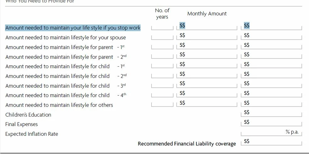

Hi, I have no Java Script experience, wanted to create more complex calculation on DC Acrobat Pro, but only know how to perform basic calculation by using simplified script. Please see attached.
assuming I created field for No. of years, Monthly Amount, Total amount (for row of the table)
Here are my script
12*Monthly Amount*Math.pow(1-1.02,No. of years)/1-1.02
12=one year
1.02=interest p.a
But it does not work. Does Math.pow work on acrobat or can I have any simply way to work on this??

Basically, it is supose to work on the row 1 (see attached hightlighted)
Each year (12 months) x No of years (eg 2 years) x Monthly amount (1,000) x (1- the interest rate (1.02)Math pow of (no of year(2 year) divided by 1-1-0.02) total amount of the first row will be S$24240.
