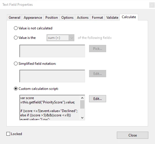

Thank you for your help.  I have pasted this into the calculate property of the field(below). But it isn't triggering the calculation. do i need to put it somewhere else?

Change getfield to getField

KMAS73,  I see this consitently on the forum, i.e., the immediate assumption that if code is not working, then some specific issue such as "it isn't triggering the calculation" is the problem. It is generally a prudent and wise practice to reserver judgement until you've actually debugged the issue.  The first step, as pointed out by Try67, is to check the console window. I would go a step farther and say you should test your code in the console first, before applying it to a field script.

In addition to the correct comments above, your code has various "blind spots", such as 5, 10 and 18, which will result in "error"...
